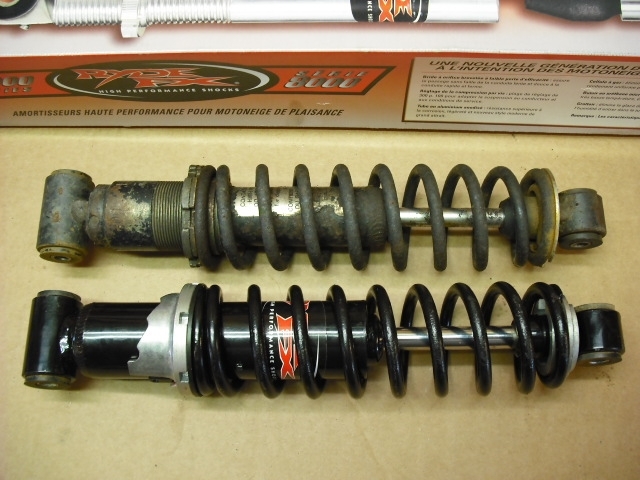

I just wanted to report back that the link I posted above does list a replacement shock that will work in my 1994 vmax 500 (supposedly it will work in all vmax's of that vintage including vmax4). I found a dealer in Wisconsin that knew exactly what I was looking for and sent me the shock for about $120.00. The shock looks nothing like the original, adjust a little differently and you might have to grind (according to this dealer) the rear pointing shock mount on the skid just a little to make room for the bigger collar on this shock but not even sure you have to do that (although I did, super easy to do, once you mount the shock bolt and move the shock a little you will see what I am talking about). The generic part number is 8203, the brand I went with was RYDE FX part number 738203, here is a link to a pic that shows the difference between OEM and the replacement shock http://www.vintagevmax.com/vvforum3/download/file.php?id=141&mode=view . It cost me $80.00 at a motorcycle shop (Austin Texas no snowmobile dealers :-) to get the springs mounted on the new shocks for the front and back.
I was going to use the old shock but glad I didn't as once the spring was removed there was no resistance at all and dust/dirt would come out each time I collapsed it :-).. I now have this sled in shape just in time for the rain and 50 degree heat in northern MN in February no less :-(... Oh well I'll haul the sled up there and then launch the boat. LOL
