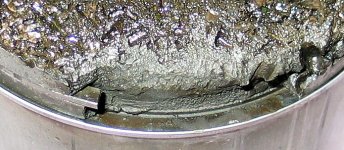

Mine did that for the past 3 rides, just not 100%. I have been lightning my fly weights since I put the taller gears in and have been jerking with the HH’s Well, Sat. on a not so frozen reservoir up on Tug Hill, I found out why I have been loosing RPM's..... I also got a small backfire at about 40mph every so often. I know something was going south and I pulled my carbs/reeds/cages all looked good. I actually thought I sucked a reed stopper part in. But, I looks like I busted a ring. I am betting I did it about 3 rides ago when I looked down and 10,300 on my tach on a super long run in -10* temps. The rest of that 3 day ride my sled just was not that same. So, I think that is when the trouble started. The cool thing here is that I drove this sled off the ice and pulled the plug (which had the electrode smashed in) replaced it, started it up and drove it back to camp 30 miles running at 8000+ RPM's. Got back to camp and all she had was 50 PSI. I ended up riding the spare SRX for the rest of the weekend. Doug

wow doug that thing is messed up

It looks like it, but it still ran fine. You could not hear the difference and if you look at the center of the piston it's perfect (see my other post called looking for parts). So, on a sunny day looking into that black hole it all looked fine. So, I drove it back to camp and I did not baby it (because I did not care if it got more wrecked) and I was not walking 30+ miles. I then started it the next morning and drove it around the house and put it in my truck for the drive home. We were all amazed at that motor. It still had 50-60 PSI yesterday when I took it apart. Doug
