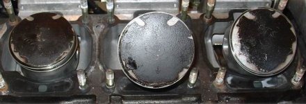

Very safe. A pencil eraser thickness of wash around the transfers is about perfect.
mrviper700
VIP Lifetime Member
ya, its a little rich
you should be good to about 70 below zero!!!, your way,way to fat!!!
Srxspec
Your #1 performance shop!
Hey, you've never even seen him, don't call him fat Mrviper! LOL!
I concur with Turk & Mrviper, you've got room to spare on the jetting!
..SNAKEBIT..
Thats what I thought never really did the wash thing but from what I thought it looked like it was washing off alot of the top
Millinocket Rocket
i'm green at this, so what tells you it's too fat-- more metal showing? what's a good wash supposed to look like? thanks
..SNAKEBIT..
CORRECT me if I am wrong!!!
small washed off spots by transfer ports (Turk said pencil eraser size)
rest of piston colored not clean aluminum

NO WASH?
was I correct in what I stated above?
Thanks
Thanks

well I will have to monitor mine alot closer this year cant afford to waste that gas LOL
tagoes10s
Anyone have picture examples of what wash is ideal?

pto is a hair on the chubby side, those aren't bad tho
