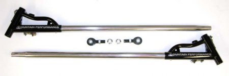

Anybody used Mountain Performance trailing arms on Viper?? i was thinking of getting some of them and was wondering how they hold up. :bling:

Yup
They are great! Just don't buy the aluminum arms, they bend like a noodle. Buy the chomoly.

yes don't use aluminum front end pieces they bend very easy my brother's cb performance a-arm's bent where the shock mount's too just from jumping and no the shock's were not bottoming.
