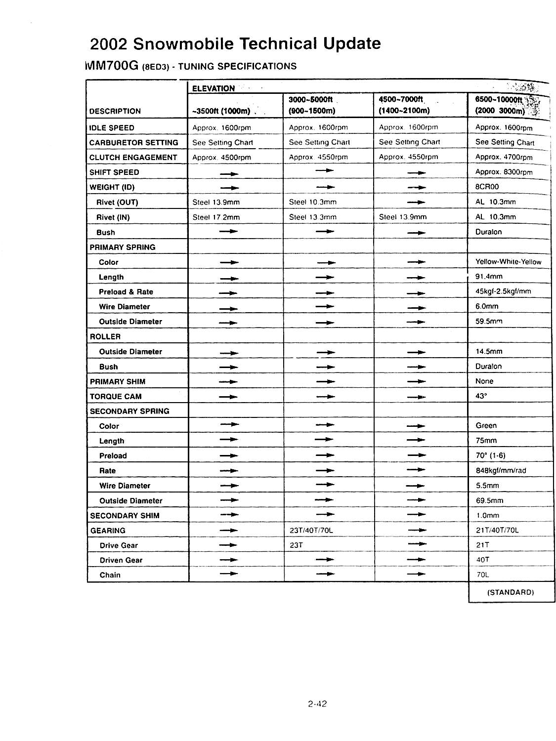

1badz New member Joined Nov 19, 2005 Messages 179 Feb 28, 2006 #1 What's the target rpm a 700 MM should be clutched to? E erik b VIP Member Joined Mar 26, 2005 Messages 101 Age 51 Location AK Feb 28, 2006 #2 http://www.zenitram-inc.com/Manuals/MM700TU1.jpg 1badz New member Joined Nov 19, 2005 Messages 179 Feb 28, 2006 #3 erik b said: http://www.zenitram-inc.com/Manuals/MM700TU1.jpg Click to expand... So the shift speed of 8300 is the top out rpm?? T Turk TY TECH ADVISER Joined May 2, 2003 Messages 2,806 Feb 28, 2006 #4 8300-8600 is fine 1badz New member Joined Nov 19, 2005 Messages 179 Feb 28, 2006 #5 Thanks fellows! You must log in or register to reply here. Share: Facebook X Bluesky LinkedIn Reddit Pinterest Tumblr WhatsApp Email Share Link
