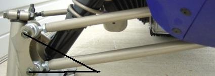

I found a pic of the 2 L shaped brackets that hold the W arm bushings I mentioned adding a grease fitting to.Drill and tap a hole in the round part of the bracket where convenient to access a grease fitting so it'll make maintaining them more trouble free.Hartman Inc or Mountain Lites used to make aluminum replacements with a fitting installed but I cant find a pic of them.
