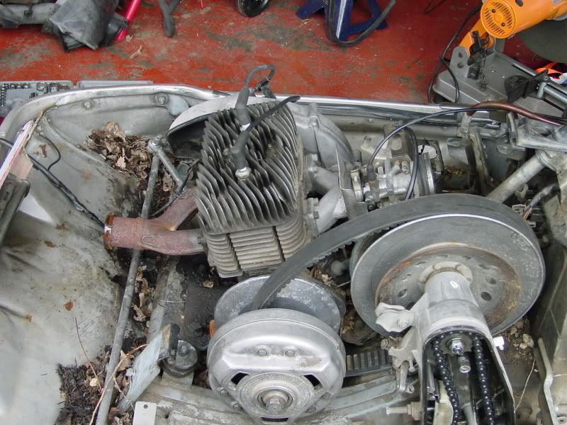

I got a snomobile chassis with an engine for a Go kart project and I dont really know what it is or if the belt is the right one or not. Here are some pictures to help also the chassis has an Id # of 8G8-005786 and the engine says 338-005786. So all I know is that it is a yamaha 340cc thats about it.

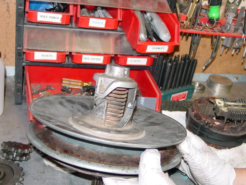

Also I need to take the secondary clutch apart so I can put a longer shaft on it but am not sure if all I need to do is knock the drift pin out of the center or is there more?

Although my pre-1980 chart seems to be missing, I am quite sure that is a 1978 ET340.
Yah, hold the cam in place and drive the spring pin out. Make sure you note the location of the spring and the shims before you take it apart.

its deffinatly a enticer 340 as Ding says. Not sure about the year. And yes he's correct about the secondary also

ET340 for sure, just like the others said.
Looks preety old, as the primary is the REALLY old style, but not sure of the name. It is unlike my bravo clutch, or the older phazerII clutch or 89Et340 clutch.

Just finally talked to the guys at yamaha and according to their books it is a 1978 ET340 B so an enticer..

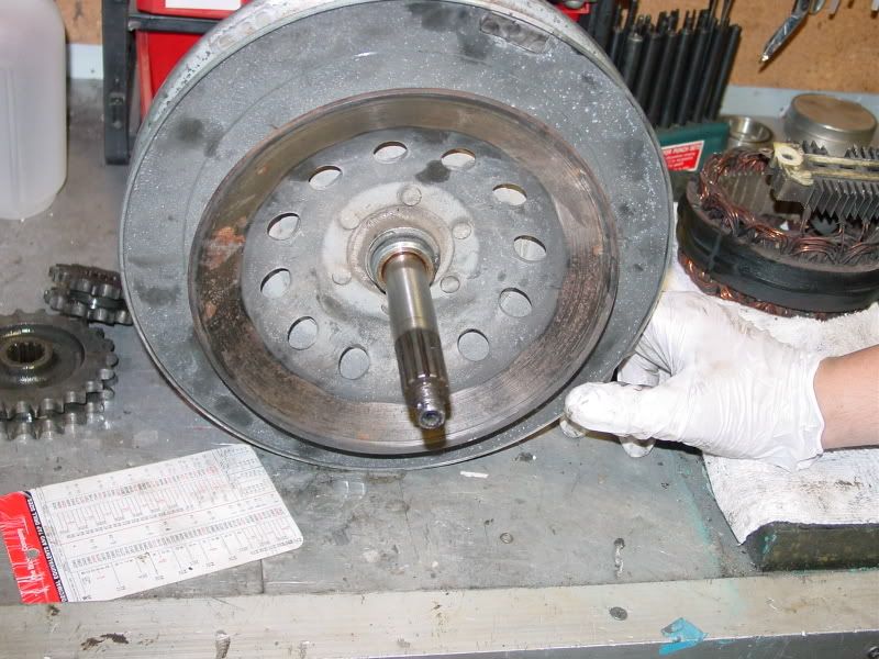

Now I got the spring side of the clutch off but dont know if I can get the shaft off.. Is it a pressed fit or something it dont wanna budge even in the shop press.. but I dont wanna worp it so I havent gone too nuts on it. what do you guys suggest?

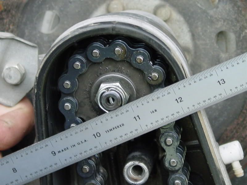

Also does anyone know what type of chain that this would be like type 40-41 or 35 or is it some metric bs i wont be able to find
