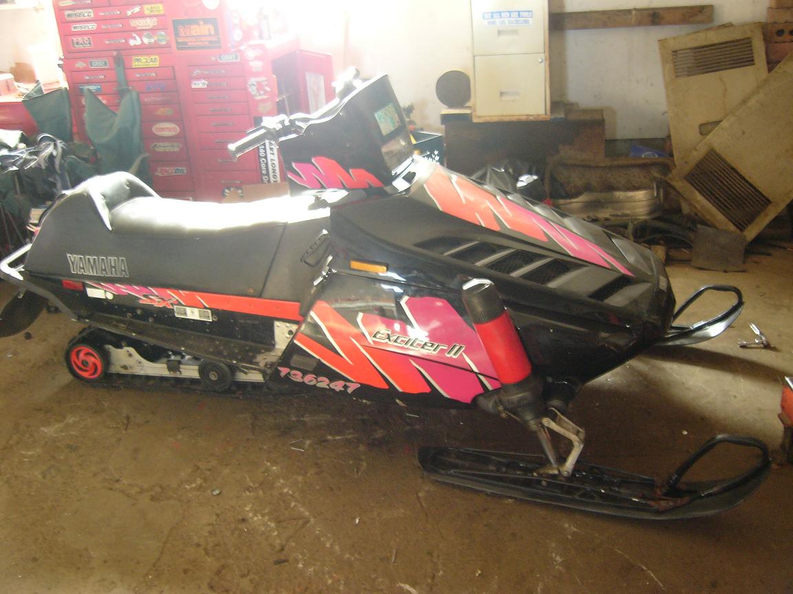

I mounted the arms 23" apart, and managed to use the stock rear mount. I used some 1/4" thick 4" angle for the front arm, mounted outside the tunnel while adding extra support for the running boards.
Fits very well, I can't wait to ride it now. Bouncing up and down on the seat in the garage just aint cutting it.
I think it's about 1.5 - 2" higher now in the rear, and the approach angle is MUCH improved. I think it will be better in the deep snow...
Now, if only I could lift the front up a bit to compensate...? idears...?

Nice Sled ! I want a SX ! The 94-96 Vmax 5/600 struts are 15 7/8" long and overall with the upper spring shaft (?) 26", The top housing (red on my sled) are 11 3/4". The picture of My Exciter with Vmax struts the distance between the ski knuckle and steering yoke is 6 7/8" and the stock Phazer beside it is 5 1/4" which is the same for an Exciter but, not the SX. If you know the advertized travel of the SX and compare it to the 94-96 Vmax's you will have your answer ! There are also, the 96 Vmax 600 XT struts if you can find some ?

Hmm, the VX struts do look longer.
