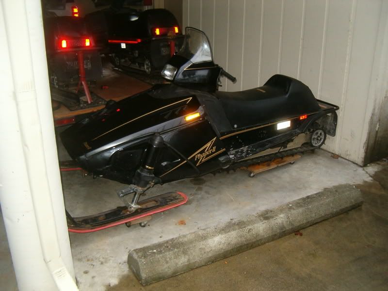

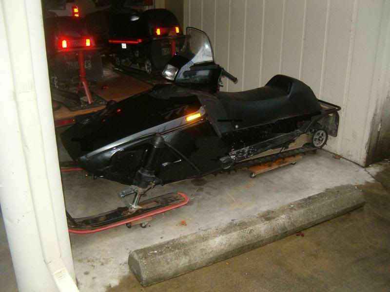

I want to remove the gold pinstriping on my phazer and I am curious as to what the best way is. I am thinking of using a hair dryer or a heat gun.. maybe alchohol? obviously not with heat. Heres some pics i made up on paintshop. oone with the phazer striping and one without..
Also what do you guys think about new graphics. I kinda like the idea of leaving it completly clean. If anyone has some cool ideas or wanna photoshop something onto it go ahead.

Looks better with the decals left on, imo.
Removing yamahas snickers...mmmmmm. Well I have had some come off good, pealing and using some mild thinner.
But more times than nun, it ended up needing d-a to remove the remaining adheasive. (sand and re-paint)
BigMan76
Use a hair dryer. DO NOT USE a HEAT GUN (search threads-lots of thoughts and opinoins).
Just stripped the decals on my SRX tunnel and used a plain old hair dryer. Worked like a charm. Then take Goo Goen to remove remaining adhesive.
