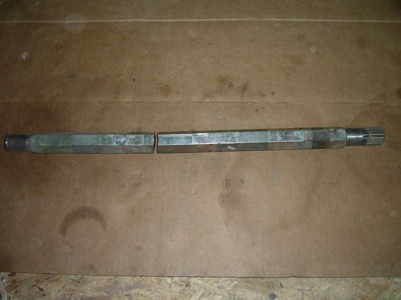

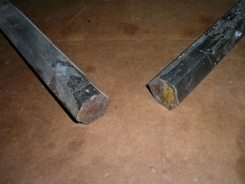

Here are a couple of photos of the axle out of my '98 Mountain Max...the shaft has been on my workbench for a couple of years, hence the rust.

You know honestly i dont know if there are any consistent tell-tale signs of the updated shafts compared to the older ones. I know that mine on my newer ones are a lot shinier silver than the two pre-2000 ones that i have, but i dont know if that is because of manufacturing or if the pre-2000 ones are just a little bit more corroded than the newer ones. Anyone else know for sure?
I just got back from the dealer and picked up the other shaft....both broke with 1/2" of each other....I'll post pictures later.
Fortunately, this time it did not destroy the chaincase as well.
