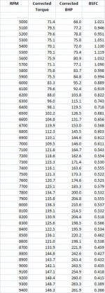

Dyno numbers are in. We had a few issues there....my CDI messed up, but other than that we had good results.
The motor built a max of 263.4 hp at 9300, and 150.0 ft. lbs. of torque. I am quite pleased.

you can darken them up if you scan them, would be nice to see the numbers,fuel flow etc. the graphs are not really that important but the numbers will reveal the power curve, sounds healthy.

I also don't have a scanner. When I get to it, I will type out everything in a spreadsheet, and post it.

Ok, now for the fuel numbers.
Of course they look scary low, but i assure you that there was more than enough fuel. The reason it is low is because of the way the CPC carbs draw the fuel, and the fuel meter on the dyno didn't read the fuel like on most carbs. All of the sleds he dynos with CPC carbs have similar low fuel numbers. We checked the wash steady throughout the day, and it was substantial. The fuel amount on this run was very safe....quite close to the mixture I will be running for my 2000' runs. I could have jetted it down to pull a big number, but I am more concerned with a safe number than a big one that can only be achieved on a dyno.

Valin, I likey!!! question: do you have solid motor mounts in it or hard durometer motor mounts? just curious as to looking at the fuel curve. I know you explained about the carbs but I was just curious. thanx

The mounts are just hard durometer, with a solid torque arm that goes from the pto side head down to the bulkhead near the jackshaft, as you can see in the picture. I am thinking about going solid for the rear mounts though. I want to see if the motor torques under a load first.
Just be carefull with the solid mounts and hard durometer mounts, they like to foam the fuel in the float bowl from excessive engine vibration and your fuel curve will get all wacky, when you add a bigger jet it gets even LEANER as you suck up more of the foam then fuel. I had this very problem on a dyno.
