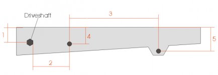

i have one where i put a 153" m7 skid into my 121" viper, these are the exact measurements i took from a 153" m7. I just used these as a reference and set it back to a 159". i you have any other questions let me know.
1. 7 3/8"
2. 9 3/4"
3. 31 1/4"
4. 6 1/8"
5. 7"

night and day difference, it rides awesome, i picked up the skid brand new with fox zero pro shocks for $300 so you definitely can find deals, if you need one i recommend call rv sports in thief river falls, ND
