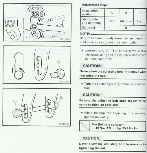

there's ignition coil and source coil here along with 600 and 700cc, make
sure your looking at the right one...

Good to hear....if you want to can save the pic's, i'm going to delete them
i a day to save server space...
