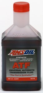

viper48
Got this info off the Amsoil website. FYI: (ATF) stands for automatic transmission fluid.

Many people use ATF, whether or not it is as good as synthetic chaincase oil, I don't know.
Yama49601
ATF is used in a lot of manual transmissions. I use Klotz synthetic chaincase lube. The stuff rules.
viper48
I guess I wouldn't want to put something in the chaincase of my sled intended for transmissions in cars and trucks. I would rather use that synthetic Amsoil chaincase fluid that is intended for your chaincase. ATF fluid is a little to thin for me to take a chance with. IMOshortstop20 said:Many people use ATF, whether or not it is as good as synthetic chaincase oil, I don't know.
