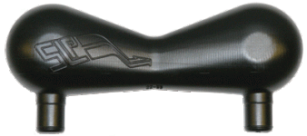

Here is a pic of one for a Polaris from SLP . . .
There is also a animated picture of one in action somewhere on the web. I just can't remeber where. You might try YouTube or similar sites.
