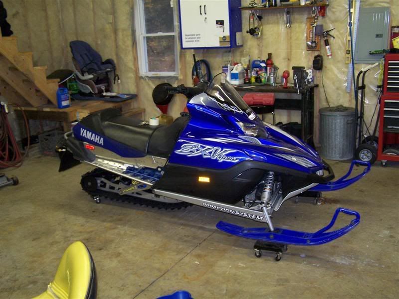

I did a touchup on my 02 viper and the one in the tech section was spot on. I work in a automotive dealership and had a bodyshop guy mix me some of this. From tech page:
PPG MIX @1/2 PINT:
DMD624 58.2
DMD675 100.7
PRL92 123.9
PRL90 132.7
DBX1689 267.3
Like I said spot on! I also tried the Honda code but wasnt happy with the result. This was better. This is after right side new paint and sticker.

This was before body work.
