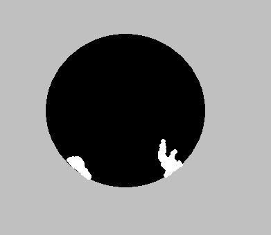

I found a little single-LED keychain light today that's really bright. It didn't work to stick inside the cylinder because the body was too long. But because it was small, I was able to put my eye right behind it and see down in there pretty well with the piston at BDC. From what I think I know about wash, I thought it was pretty good, I attached a pic I made on paint to show about what I saw. On the right side, the mark has 2 "arms" on it as shown. This is the PTO cylinder, and the others had the same shape except the "arms" didn't stick out as far. The mag side cylinder had the smallest wash marks of the 3, but they were all really close. I was riding at about 25-30 degrees F. Is this what I want to be seeing?
Danger Dog
Good for those temps. Might be lean when it gets colder.

Watch is when it gets to zero or below zero, for the temps you're riding at now though you're good.
I'm all stock for jetting right now, engine/clutches all stock as well, fuel screws 1 7/8 turns out I believe. I've heard that stock viper jetting is rich, but that must not be the case here. I want to be safe, what about raising the needles? I'm rarely at WOT, almost always in the midrange. I'm thinking it also wouldn't hurt to pull the carbs and thoroughly clean them, even though I already did it the end of September.

What does Yami say the coldest the stock jetting is good for I wonder? Since you're running stock jetting I bet you could ride it at below zero temps and be fine.
mopar1rules
if you're worried about the midrange, just raise the needles 1/2 clip.
According to the service manual, stock viper jetting should be okay from -4 to 32 degrees F at sea level. It gets below zero here but then our elevation is also higher (1150 ft) so idk, I'm sure there's plenty of other variables as well. I just want the most reliable sled I can have. I think changing jet sizes would be too rich, overkill, so I'm thinking raise the needles one notch and take the fuel screw out to 2 turns. or maybe even 2 1/4 turns. Sound good?
