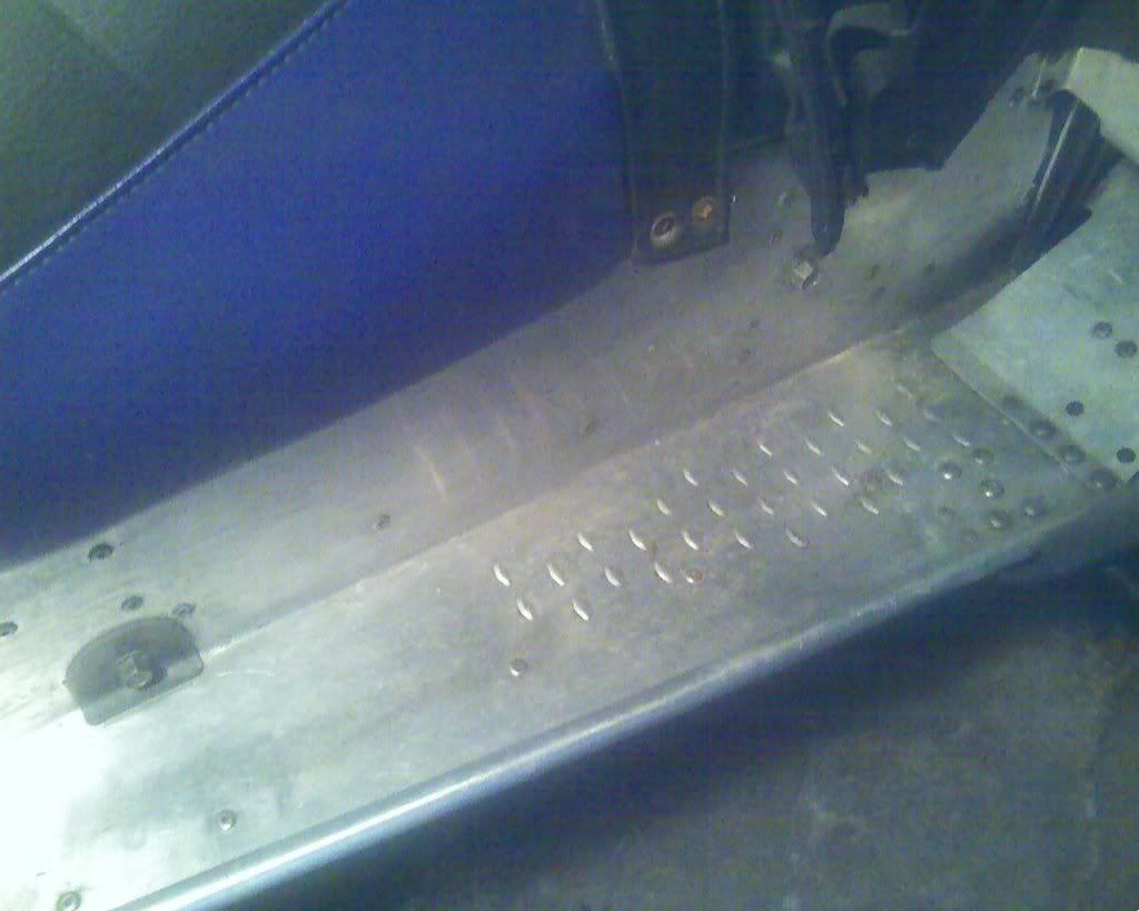

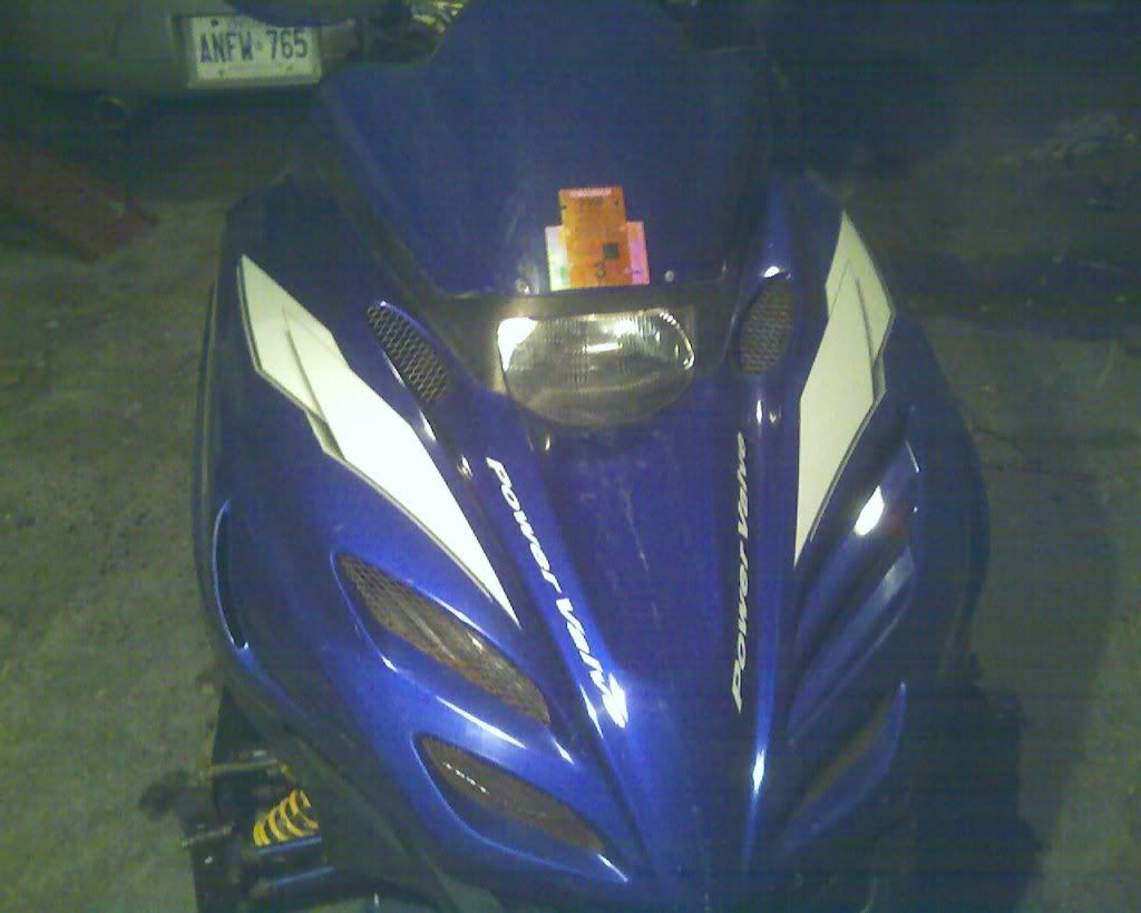

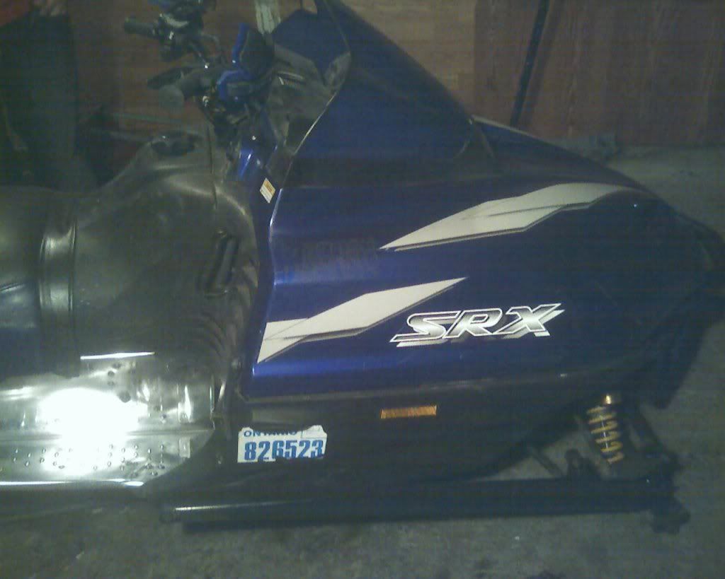

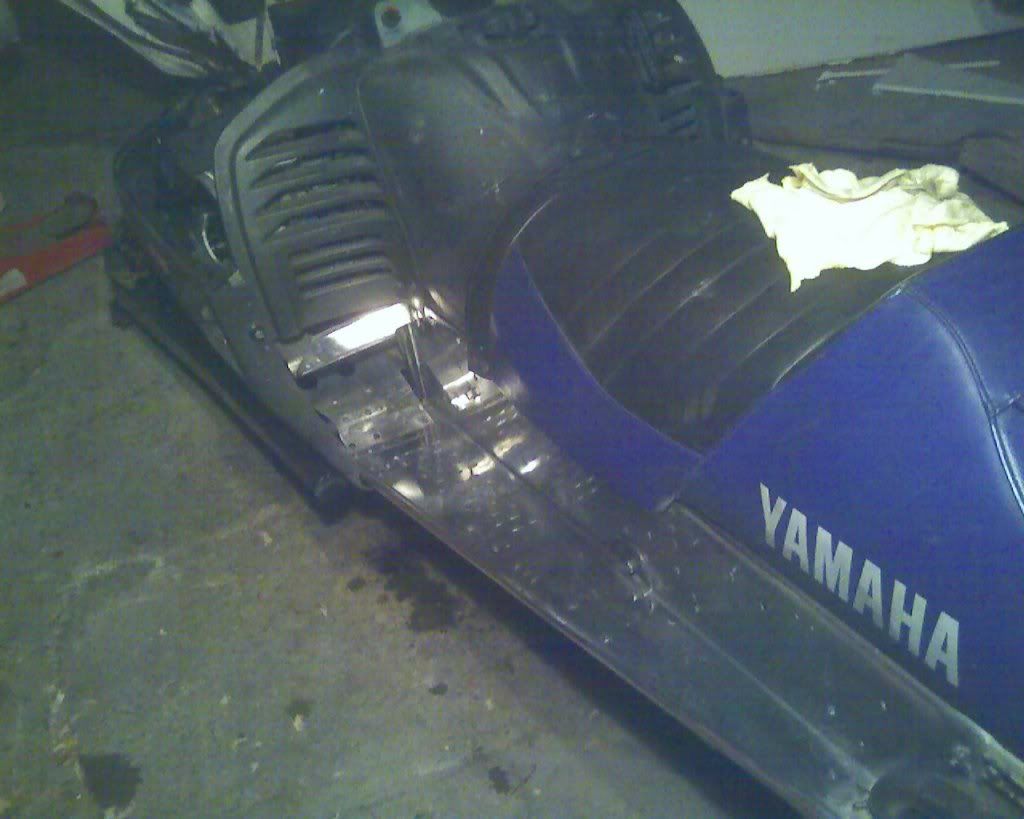

Here's what I've been up to for the past couple weeks...... (Pics)
List of things I did:

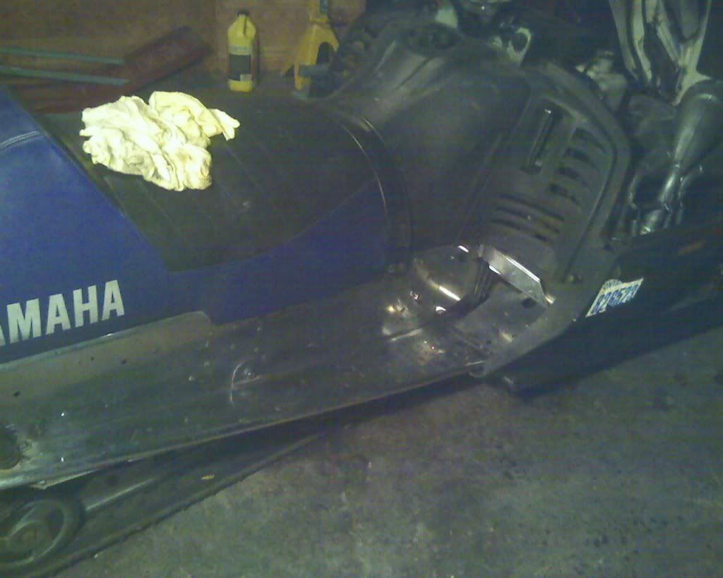

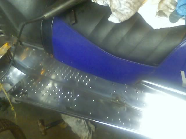

I wish I would have taken more pics, But I'm not a picture type guy. These are some of the final pics.
Pics:
Like I said, Not to many pics. But things are almost done. i want to spend a couple hours hours on the tunnel, and hood. There are a couple spots where stickers were that I want to clean.
- head work done
Polish tunnel
Clean carbs
Clean P/V's
Take ski's off
Get new ski's
Order new o-rings and other gaskets
Clean secondary clutch and install new parts
Clean Primary clutch and get work done to it
make pipes look pretty
Repack silencers
wax hood
sandblast and paint new trailing arms (Replace two and repeat this to the other two)
install all parts and clean sled
Adjust YPSV, and install new gaskets that have been sitting in a box for 2 years
Pics:
Before:
You won't believe the difference that the packing made in sound db. I say easily 20db.

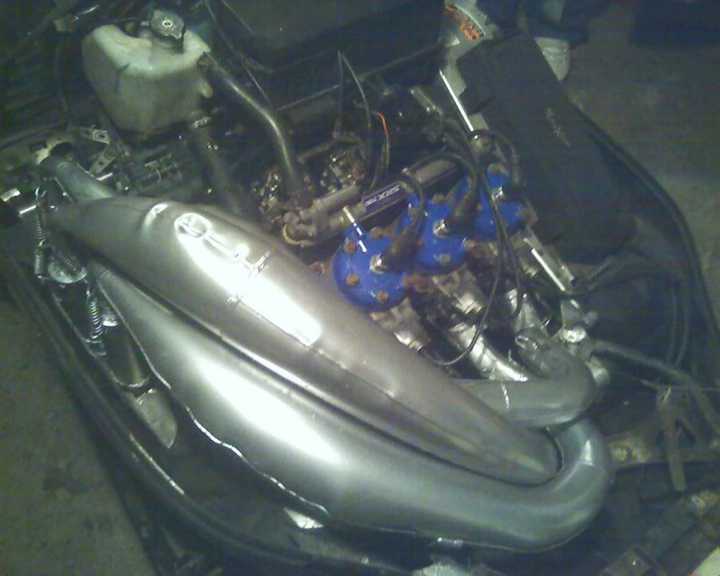

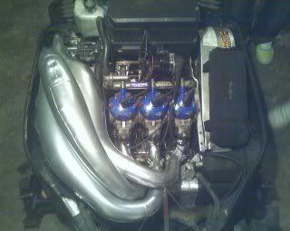

Wanna come polish my tunnel?....i'll buy you some beer....lol looks pretty clean, nice job, that one pipe looks dented on the top, did you have to do that for hood clearance or something?
Lol, You just happen to be a little far from me. That pipe isn't dented, It's just a crease from when the pipe was made. B/c It's on a bend, Iunno, It's just wavy. these pipes fit great, no matter how tight they look in there. They clear the hood, with plenty of room. The tunnel still needs hours of work, but It sure does look great.
Thanks, Nik!

what did you use to poish the tunnel I want to do that to mine also
theres a bleeder under the seat
MountainRx1
yammi man63 said:what did you use to poish the tunnel I want to do that to mine also
I just did mine on my viper, I used and air buffer and 3M Heavy Duty Rubbing Compound, then I usually finish off with something finer by hand(mothers, that kind of stuff).

I noticed that your pipes are a different design than mine even thought they are both power inc and individual silencers. The way they fit under the hood is different. Interesting....
Really, Do you got any pics to put in this thread to compare.
Also, I use a mother powerball (Got it for $5 from a friend, Brand new) And Mother Mag & Aluminum Polish.

2ooosrx said:
They're a little different. I wonder why that is?
