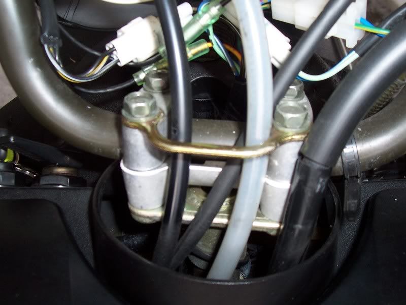

I just bought the Rox 2" Pivot riser on e-bay. Waiting for it to arrive.
From all of the posts I've read, the 2" won't need any cable lengthening. I'm 6'1, so this should feel much better when standing. No need to raise the seat for me.
I'm assuming the brass coloured metal piece is what some of you have cut off correct? Can I just leave it?
Anything else I should know before the install?

I took the brass colored piece off(don't need to cut it) of my 02 Viper,but I put a 3.5 Rox Pivot riser on mine. You might be able to leave it with the 2 incher,just make sure nothing binds up after you install it(turn handle bars all the way both ways and watch the lines and wires),and make sure nothing is being pinched.

I put a 3.5 Rox on 1 of my vipers and had to take cable guard off.
I have a 2 inch powermadd straight block on the other viper and I also had to take it off so cables would not bind when turning.
I would remove it.

i put a 2 inch riser block on 02 and 04 viper and never had to take the guard off.
