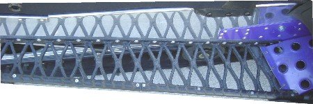

Fabcraft makes a very nice tunnel for our sleds. They are available in 121" to 166". I don't know how much a Yamaha tunnel is, but the fabcraft is $900US for a standard tunnel, and $1350 for a tunnel built with running board coolers, and a U-shaped cooler in the rear already installed. I still might pick one up next year for my 144" SRX build.
http://www.fabcraft.com/partlist2.php
