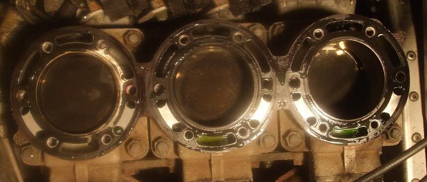

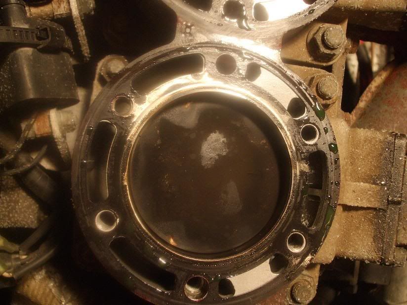

I pulled it apart tonight to have a look:
There's a leak on the mag cylinder - the shiny area on the gasket. Looks like I'm going to need a new head gasket. There isn't much evidence of a leak on the piston dome, it must have been pretty small. You can see it's a little wet in places, but not washed clean like a big leak. I attached a pic of the spark plugs as well, and they look pretty much the same across the board. The mag side plug is slightly darker in a few places.
On side note, what do you guys think about the piston wash on the other 2 cylinders? I've been running at 0 degrees F or less.
