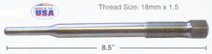

josef.with.an.f
is number 1 in that picture hollow? where as number 2 would pass all the way through it? because what i was using was like number 1 with a bolt head on the end with number 2 attached to the end of it. similar to the main shaft of a steering wheel puller.

here is a btter pic of the correct puller and a link to buy one online....$20 for a imported tool......
