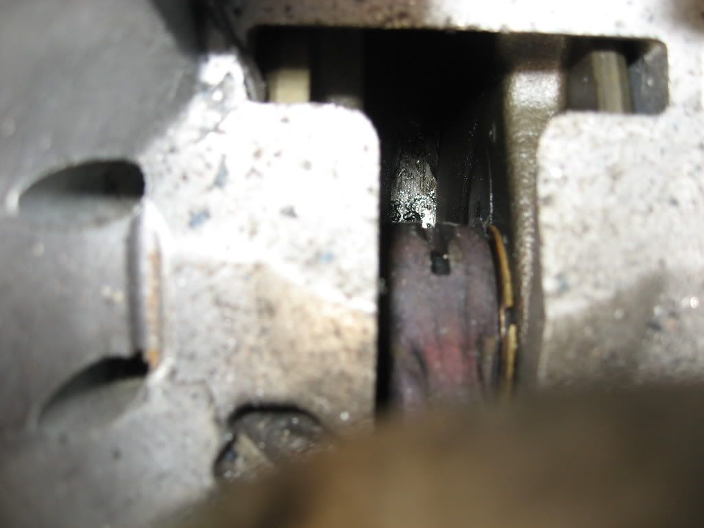

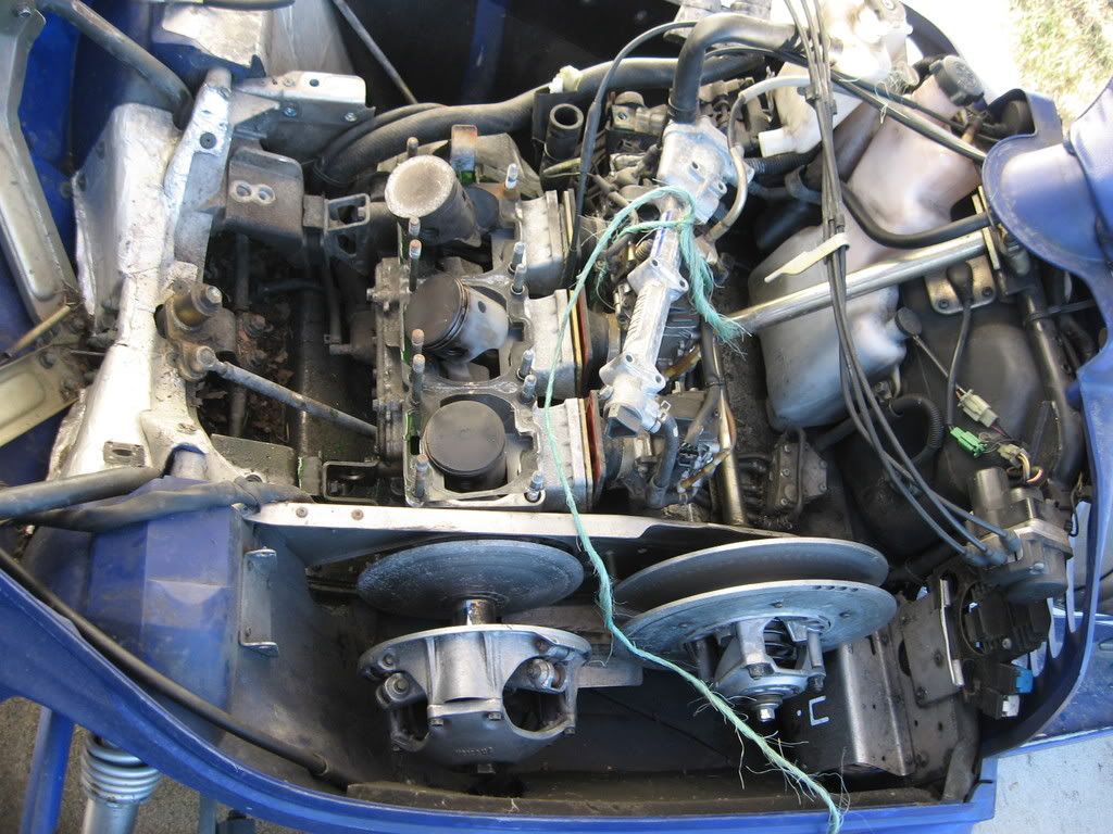

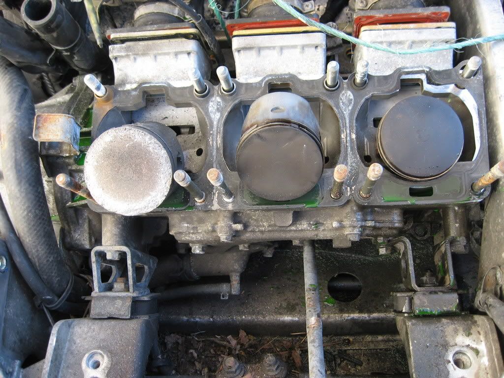

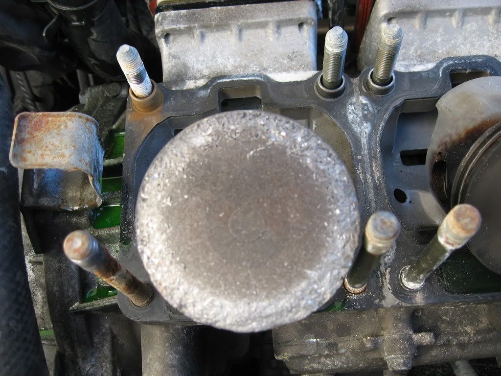

Hey guys, new to the site, and yamahas. Bought this 2000 SRX today knowing it had engine trouble. The guy I bought it off was told that a bearing had let go in the bottom end. Took all the jugs off today and found cyl.3 all chewed up! So how do I go about repairing this? Is a replacement engine in order? Or is there any hope left for this motor? Any help and comments are greatly appreciated! Here are some pics...

yea 2000,,big pics wow,anyway how does the crank turn??
looks like connecting rod bearing went. kirkswims viper looks the same. there is a site member on the 4 stroke side with a good crank for sale. do not remember the name.
Get a good used crank and a replated jug from US Chrome or one of the other vendors along with at least 1 new piston,some people like to do a 3 at once so they know what they've got.I'm sure you know this anyway but new crank seals will be needed when the base goes back together to give some peace of mind.With that kind of pre detonation did the head get banged up too?I'd bet you could get most of the stuff your going to need on the classified forums.

Thanks for the advice! Do you think the crank case will be ok? Or will I only know that when its all apart? And as far as putting in a used crank, will anything need to be done to the crank case to accept the used part?fourbarrel said:Get a good used crank and a replated jug from US Chrome or one of the other vendors along with at least 1 new piston,some people like to do a 3 at once so they know what they've got.I'm sure you know this anyway but new crank seals will be needed when the base goes back together to give some peace of mind.With that kind of pre detonation did the head get banged up too?I'd bet you could get most of the stuff your going to need on the classified forums.

And yes, the head got all marred up, so probably will need one of those too.

That bearing may have just failed BUT make sure everything fuel wise is in order, like clean carbs, check jets. Id also pre-mix until your SURE that its getting the right amount of oil/gas...
The case should be just fine, you lost the rod bearing much better than the main BUT that being said Im sure that rod bearing contaminated the mains so like others suggested, get a low mileage crank ASSEMBLY with outer mains.

While engine is out the SRX's are notorious for wire rub through underneath the engine. SO check them and either re-route or put some type of wire wrap to make sure no issues later.
