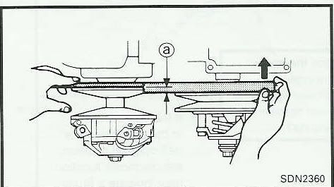

How do I align my clutch on '01 SX500 - motor mounts all loose and engine has alot of play in the frame. Are there any tricks or do I need to buy a special tool.

you'll need clutch aliment tools to get it spot on,you have to do center to center and off set ,can be done with a tape measure but it's tough and it'll only be close.
CTC is 268.5 mm
off set is 15 mm
CTC is 268.5 mm
off set is 15 mm

Where can I buy this tool? I looked at Dennis Kirk and didn't see anything for my model.

One of the site sponsers(rich or port yamaha)should be able too hook you up or your dealer or search online.
