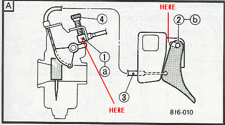

there's 3 point's of attack here:
1- Check throttle free play (2mm) adjustment for that is here
2-3 check both switches,make sure there clicking and returning right,the
one up @ the throttle block you'll need to remove the thumb lever pin
remove the thumb lever and look down in you'll see the switch,stick
a small screw driver in and make sure it's moving good in and out..
also you can use a simple volt meter to check the switches out,just a
simple switch that breaks the circuit or completes it..
