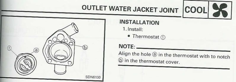

Is there a particular way to place the thermostat back in the housing?I noticed there is a tiny hole in the backplate of the thermostat and there is a notch out in the exterior housing that covers the thermostat.Do I line the hole with the notch? Or do I place the thermostat with the fixed arms a certain position..vertical or horizontal?
It's ok,I found it in the manual.Hole in thermostat has to line up with the notch.Now if I can only find where I placed the 4 bolts that hold down housing.Can't believe I can't find them now.Somewhere in the garage....

yeah I know.I couldn't wait for an answer,wanted to go riding.Then remembered the manual on CD,so checked it out and sure enough they show a diagram of thermostat and procedure to re-install.Good thing to have handy that CD,thanks to mulderdad.

Hole?Notch?Geez I had mine apart in January to polish the coolant rail and can't for the life of me remember if I lined anything back up when I put it back together.What's the signs of a misaligned thermostat?bluemonster1 said:It's ok,I found it in the manual.Hole in thermostat has to line up with the notch.Now if I can only find where I placed the 4 bolts that hold down housing.Can't believe I can't find them now.Somewhere in the garage....![]()

fourbarrel..yeah it says to line up hole with notch.I was thinking if you turn the thermostat the wrong way,you may restrict the flow.I'll get you a pic of this from manual.
I can't seem to scan the pic of it.Maybe daman can do it for us.
'98-99 fourbarrel is the same
there's a notch in the stat that when lined up with the housing it alows some coolant to circulate during warm up.
thank-you damn..your da man. Manual comes in handy doesn't it.
Pic is worth a thousand words.
yep.I bet a lot of guys didn't know this fact.I didn't until I had to replace one and noticed the hole and notch and then questioned it.
