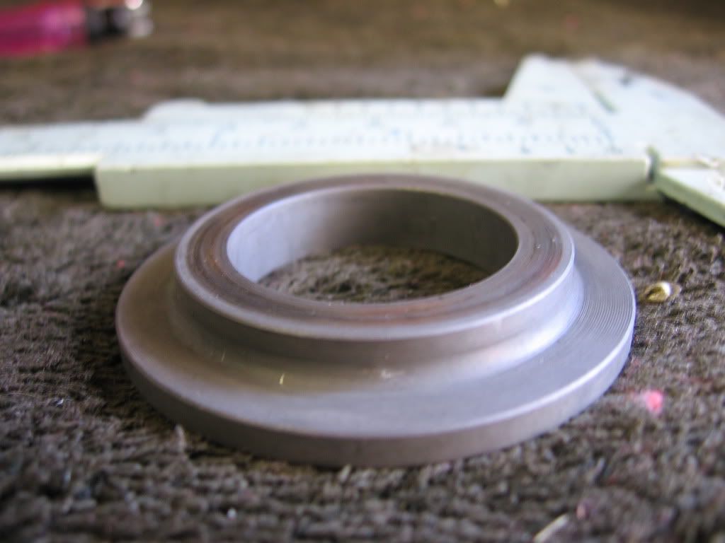

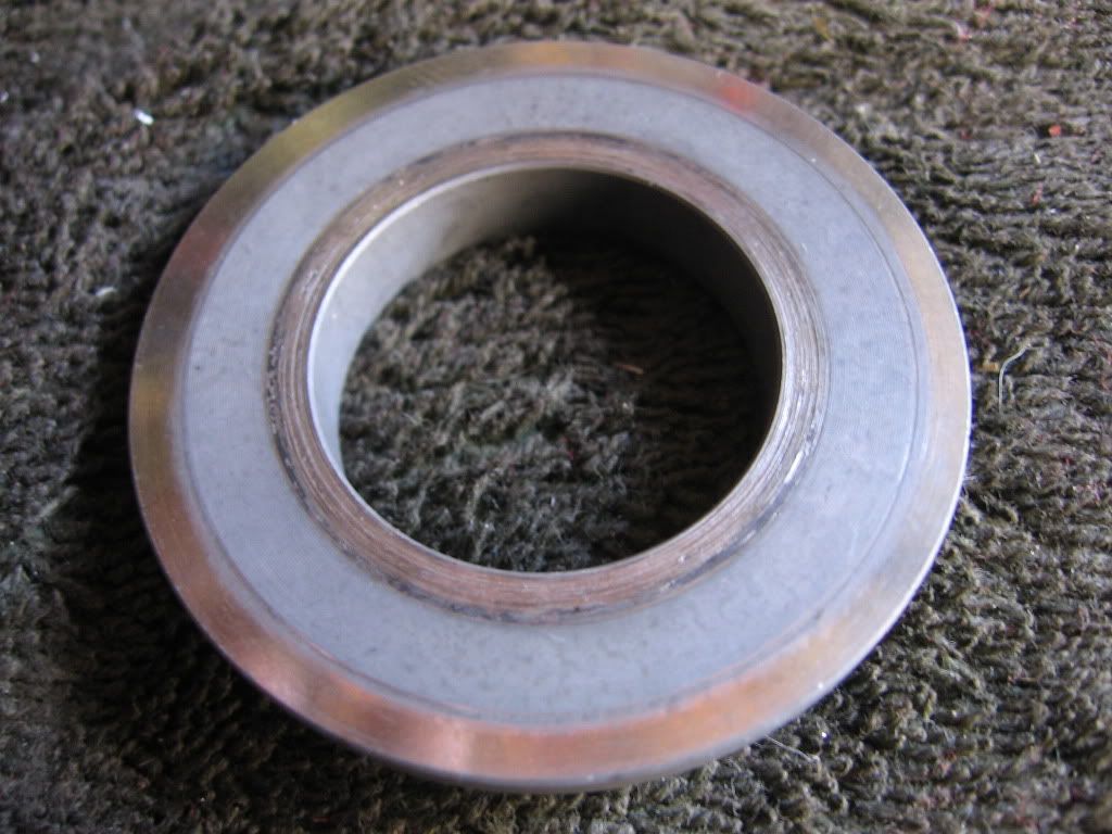

I am working on 3 sleds at the moment. I pulled down 2 at the same time so nothing is missing ( 00 sxr 700 & 01 sxr 700). Well everything was going well till I got to this washer-spacer. So I pulled the ( 98 vmax 700) down to compare.
I thought this went on the top axle on the skid ( where the middle bolt mounts to the frame on the inside of wheel on drivers side)
Also I was working on the chain cases and I was looking at the parts fisch and it shows a spacer on the bottom gear near the frame ( 19 ).
Well the 98 does not have one there on either side so where does this go???
Anyone know?
Anyone know?
thanks

francis6667
This washer go to the bottom shaft in the chain case on a sled with reverse,the small end on the bearing.

thanks. I tore one of the chain cases apart today to check it out. Looks like somehow that spacer ended up beside my skid somehow and then you know how it goes.
Anyhow now I can continue with getting these done tom.
