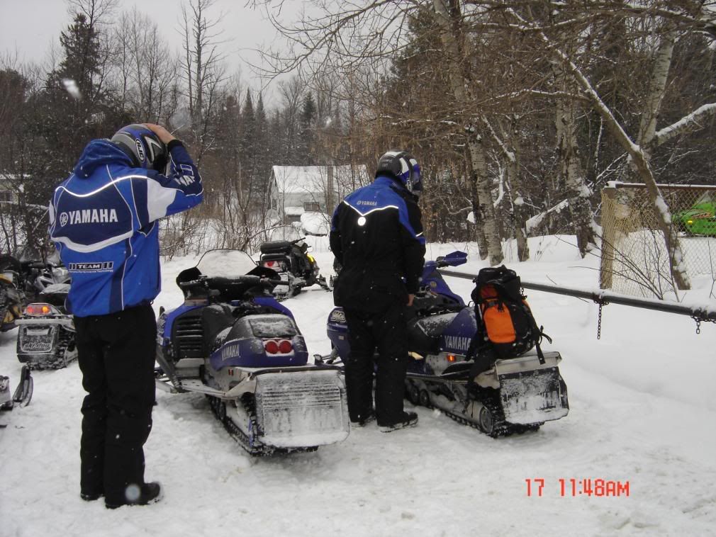

I used a 2000 MM 141" tunnel extension along with the factory hose covers. I only have a 136" so the extension looks a little long but not that bad. The 141 is not too much shorter than the 144. Here is a pic, kind of hard to tell from the angle.

That's a good picture of the overhang on the Viper. Too much for my liking, but as I said, unless you spend the bucks it's the only option available. I though the SRX cooler and the Viper cooler were about the same. There's no way the Viper cooler I sold would be hidden as the one on this sled apparently is.
