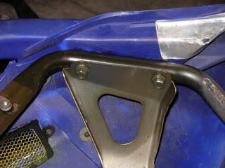

hey i need some help on how to remove this bar, its bent on my sled and i need to install a new one,what all needs to be takin off to replace this ? any help is great ! in the yamaha manual its called ( bumper, front 2) its the bar ur hood latches bolt onto , its black!
help is right!. figure on a motor removal to get at all the fasteners on that one. couldnt have picked a better part to change to get to know your sled a little better. thats one of the more structurley integral parts under the hood. start by removing the pipes, and then you will see. its pretty straightforward, yet time consuming. then you need to factor in the fliud replacement and clutch alignment.

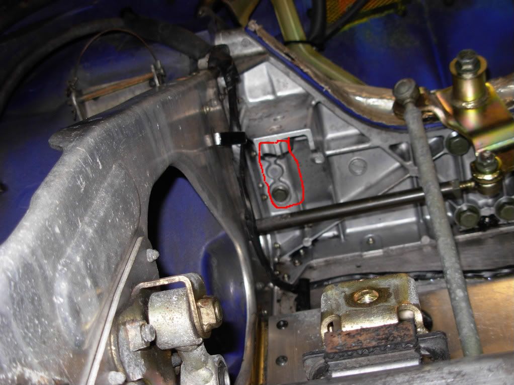

i think you could get it by removing the pipes and not the motor, wont be easy but i think it can be done, remove the hood, then remove the 4 bolts here 2 on each side

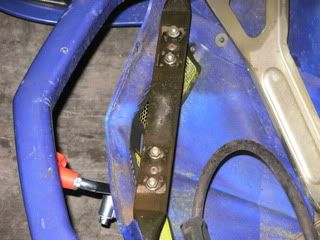

then there are these two bolts here and two on the other side same spot

LMFAO I had to do the exact same thing last year and no you don't have to pull the motor but the pipes have to come off and if I remember correctly you do have to take the mounts out one at a time to gain access to a couple of hidden bolts in or around the bulkhead...
