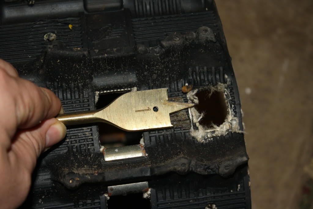

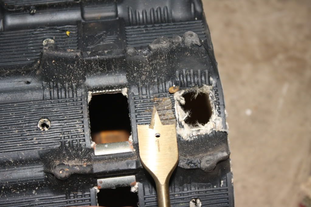

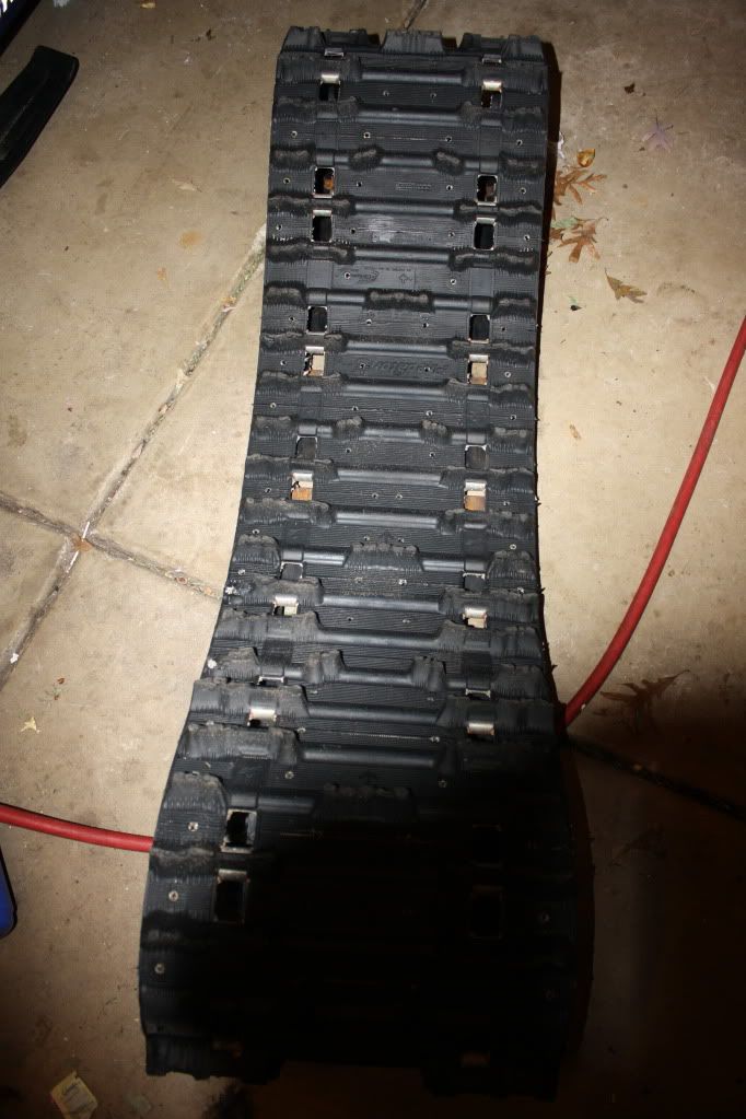

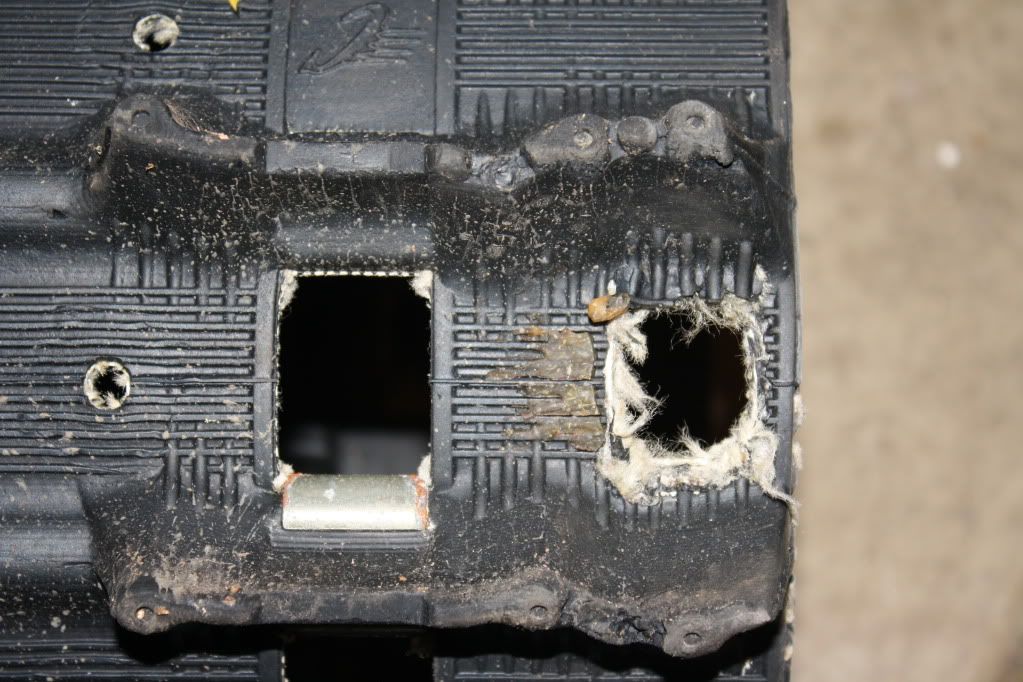

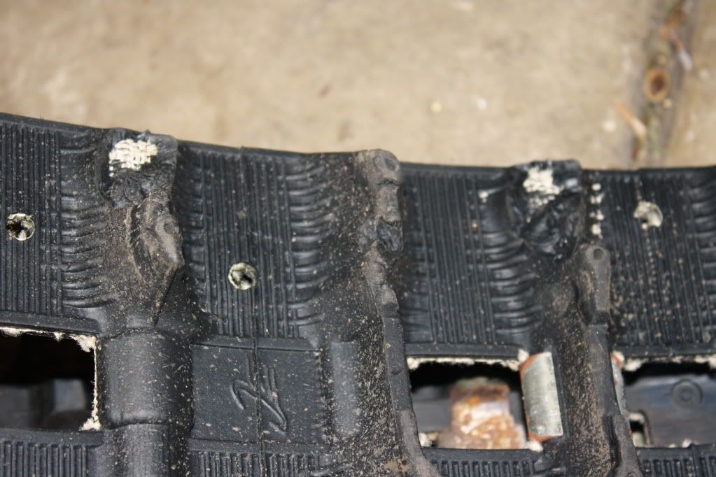

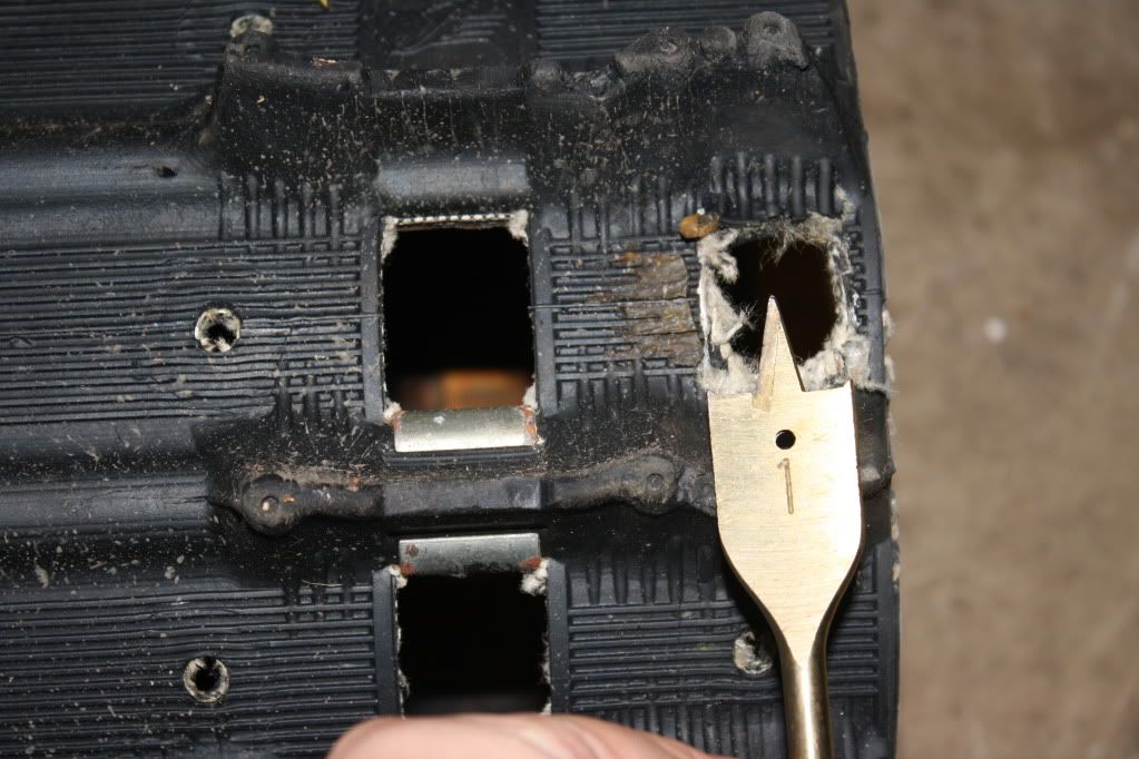

These are pictures of the track that just came off my 2000 SRX. As you can see, it is missing a few lugs and has 1 pull thru outside of the window. I'm thinking about putting it in a 97 sx 700 that needs a new track...Am I asking for trouble running this? Should I try to repair it? Thoughts?

The torn lugs are no big deal. That pullthrough on the outside is going to give you issues.

That pull through on the outside is something I would be concerned about. If it were on the inside belt it wouldn't be as big of an issue but there is nothing more scary than not having brakes when your track blows out. If you are just going to gently trail ride it then you should have no worries but i wouldn't abuse that track with hard spinning acceleration or top speed runs. It is a matter of safety more than anything.
