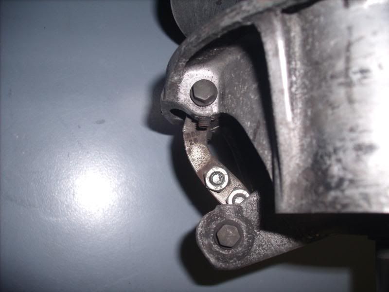

Pulled the clutches off the SRX to clean em up and see what I had. Primary clutch had orange/redish spring(no markings) w/ 8DN-20 weights. Are these aftermarket weights? 8DN sounds like a Yamaha number but ive never seen factory weights with bolts in them.

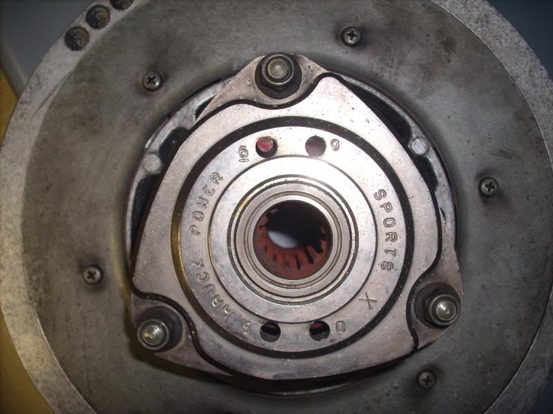

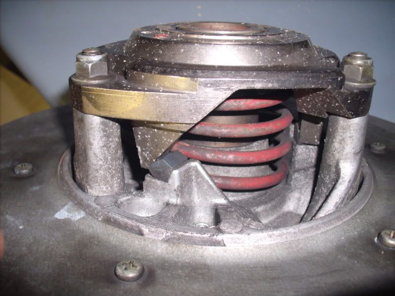

Secondary has a Hauck helix. Any way to tell what the specs are on the helix? The spring is on the #2 hole on the bottom.
Is this a good baseline clutch setup or is it way off? Sled is a 00 SRX 700, stock engine. Stock gearing. .920" track w/ 144 studs. Ride 90% groomed trails. I weigh 210-220lbs. Ive never ridden this sled so im not sure what max rpm it runs at.

i'm about positive thats my old sled, that clutch setup worked good, the bolts are just easier to tune than rivets, yamaha weights. can't remember what helix that was anymore, i sold that sled four years ago, but it worked pretty good from what i remember. and yes my hood was painted by the previous owner, it has alot of copper pearl in it so at some angles it matches the plastic good and others it looks like $%#t, so i'm going to repaint as part of my build. i'm hoping to be done by mid jan. but stuff keeps preventing me from working on it, so we'll see

A Hauck X is a 52/47. My brothers 01 srx has the same clutch kit. It works real good.
