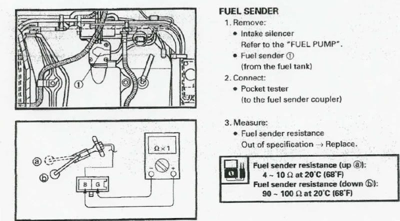

the sending unit goes in from the front of the tank behing steering post, its about a 2x2 square flange with wires coming thru and 4 bolts you'll have to remove the airbox for sure, ive never tried to remove one with the tank on so i cant say for sure if you can do it with the tank in, maybe someone else has tried
yep comes out in the front
