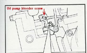

What is involved to set this pump up. Purchased a new one and want to make sure it is set right.
Thanks
Thanks
first off fill the oil tank then open the bleed bolt run oil out till air is gone.
then set oil pump.....
