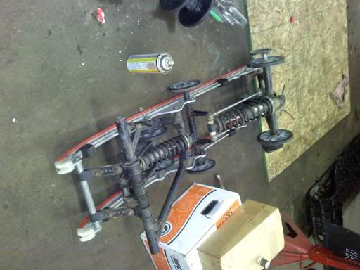

Ill tell how I start is this: sitting on the sled, I want the snow flap in the rear to be about an inch off the ground, assuming a flat hard surface. You can fine tune it from there depending on your riding style!

How much time did you spend on that skid to make it look that good?
Heres mine
Heres mine
im was gonna say those are some pretty shiney rails you got there..

I also neglected the fact that I made and installed 3 1/2" drop brackets for the rear. Upon reviewing the drop bracket thread I noticed that many people recomend dropping the idler wheel axle down half the distace to maintain the correct geometry. I did not do that yet so that may also be part of my problem.
I spent quite a bit of time on the rear skid... I'd say about two weeks of putsing around with it after work. I wet sanded, polished and selaed the rails then sandblasted and painted everything else. It came out great though and matches the rest of the sled now. Hopefully this weekend it will be complete... I've been restoring it since I got it early last summer. Thanks for the compliments!!!

Nice work that looks awsome
