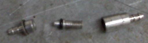

I pulled the motor last night without making too much of a mess. When I got it out, the check valve on the lines under the motor was pulled apart
It looks like it just presses back together. I ordered a new one today ($30)
Anyone have one of these just fall apart before? Nothing could have touched it because it sits below the motor.
