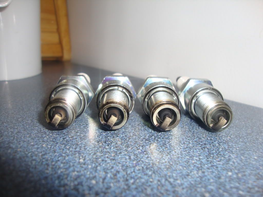

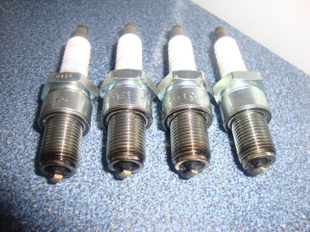

two ends look lean, two inside look rich, on oil just judging by electrodes faces
from left to right...
1-about spot on
2-ok/close with margin for error(temp drop,night riding)
3-rich
4-rich/cool
1-about spot on
3-rich
4-rich/cool
A little lean,, for what,, 2 miles? What throttle position?
lf you told the full story that you have told before, that this isnt a full WOT run, just a run around the yard. You will get the same answers as before.
ITS LEAN,
l guess your gonna keep asking untill you hear what you want.
ITS LEAN,
YAMAHIZAL700
Im no expert but my first reaction lookin is that they are all a bit lean.
