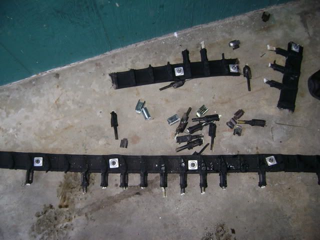

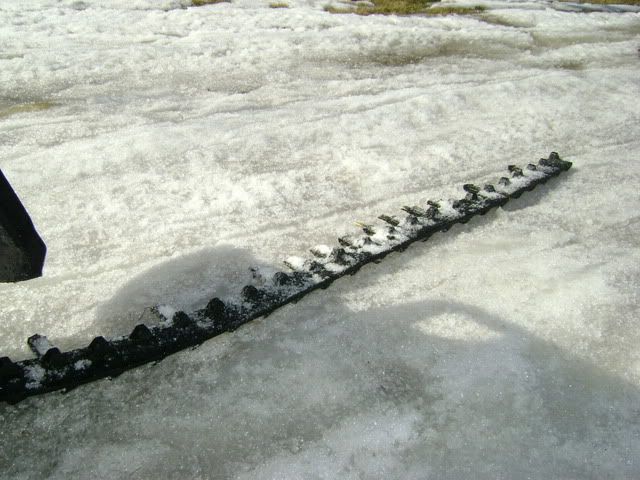

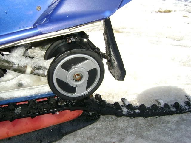

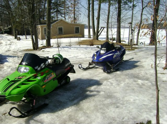

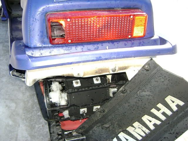

I went to take my sled out for one last run on the ice after I put stabil in the gas. Since the ice was so smooth I decided to open it up and see what it could do, Well I hit about 95 mph or so and the track blew apart. I locked up the brake to keep the track from doing more damage.
Here are the results
Had to be pulled home by a CAT
Used a knee board to slide it home
Its tail
The pieces that I could find with all those new clips that I put on a few weeks ago
Broken tail light and bent aluminum
FuzzButt said:
Lucky. You might consider playing the lottery this week. Those loose clips look new. Were they recently put on?
Yeah, there were 35 missing and some were warn through, so I replaced most of them about 400 miles ago. Im suppried it lasted as long as it did, the track has almost 10,000 miles on it.

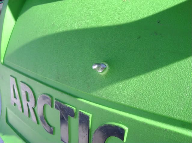

I found this in the snow flap of my Arctic Cat after doing some runs on the same day that my track blew off the Yamaha.

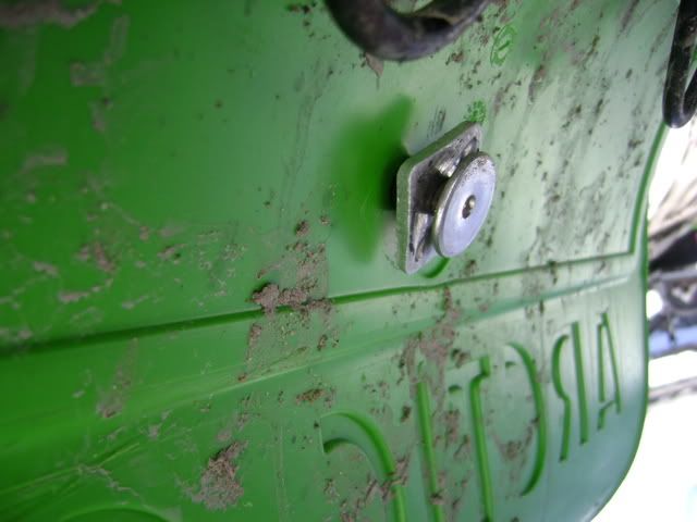

Niceee... I have a picture of my flap with a stud all the way through it to the backer.
Why would you waste the time and money on a 11yr old track to re clip it I would have just bought a newer used one.
I figured it was still in good shape when I did it. No torn lugs or missing studs so I though why not.
Live and learn I guess
