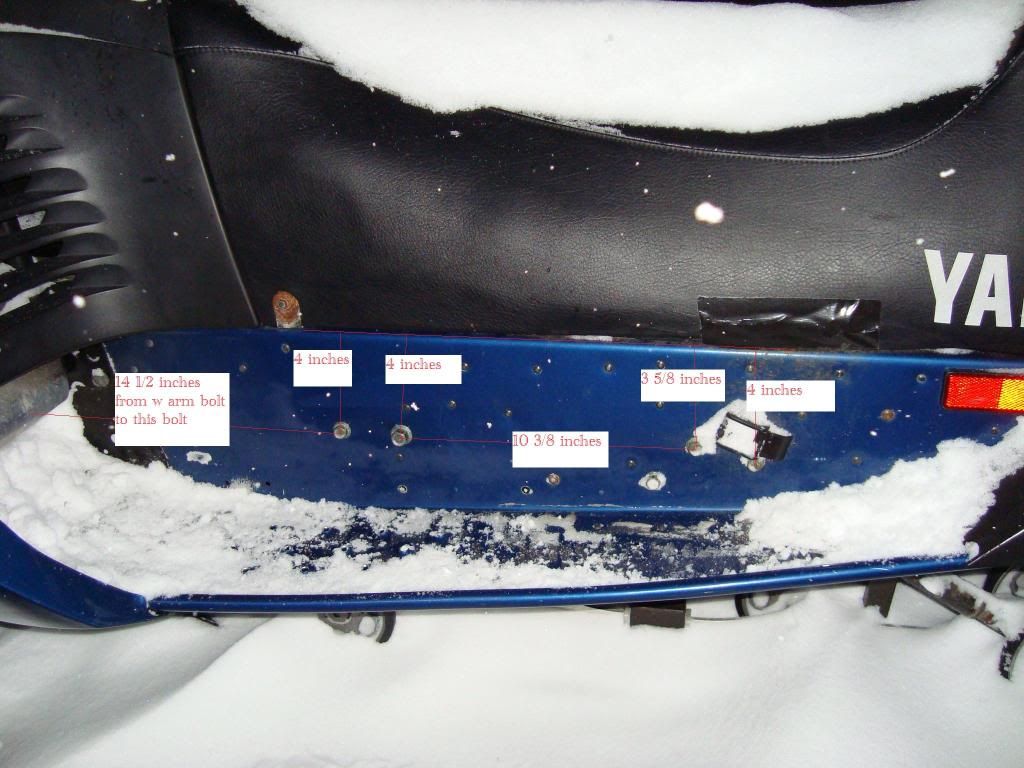

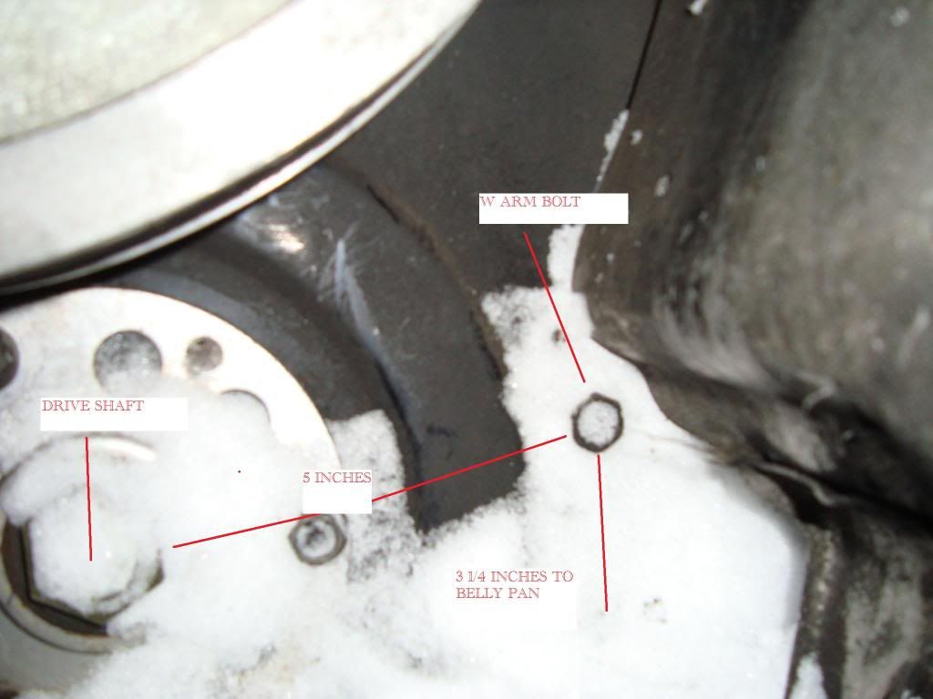

hope these photos help. and this is not my sled with duck tape on the seat.
Great help! That was totally what i needed! Pics is great especially when my language is a bit limited when it comes to technical terms
We don´t use the same meassurement scale but there´s programs for that on the net. Now i just need some shocks and then im good to go (thanx to you)
