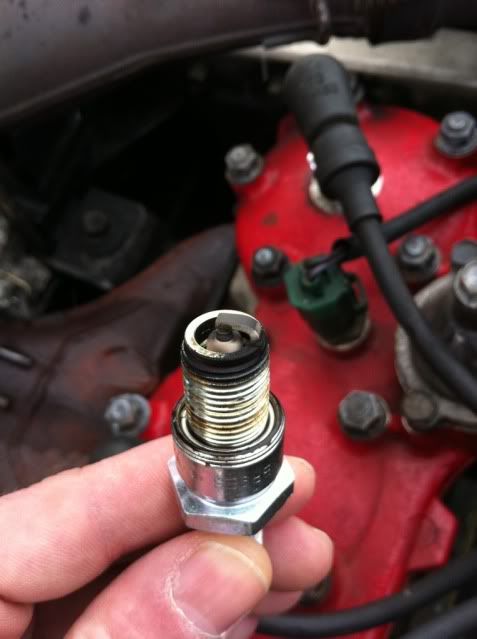

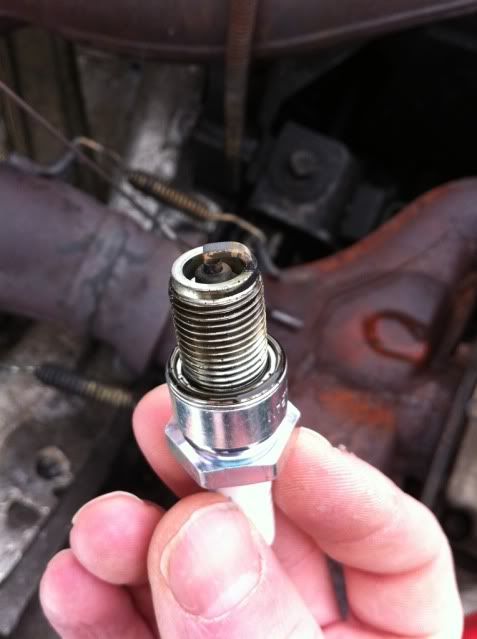

Just wondering with the pics how my plugs look. And a little speed run down the powerline road for fun today. I no the vid is shaky but it was a bit cold out today

what mains are you running? looks just a touch lean for my would be likings
Everything all stock. It was about 10* out after the run I did then pulled the plugs. I had 8s in and they seemed to be more wet than the 9s in the pic

You could have plugged pilots, or they are starting get plugged. You might also need to set your idle lower. Stock is 1600 +/-100. if it still hangs try lowering your idle more to like 1300. But do this when it is hot.

I don't wanna change anything. I'm wondering why I have idle hang and how my spark plugs look. They are at 1 1/2 turns now. And by the looks of it I might wanna run them up to 1 3/4 to richen it up a bit.

Ya I'd richen it up just a touch. Plugs look clean on one side. I'd also shim the secondary up a touch to get rid of that belt squeal. The sled should idle down a lot faster than that even after a run like that.
