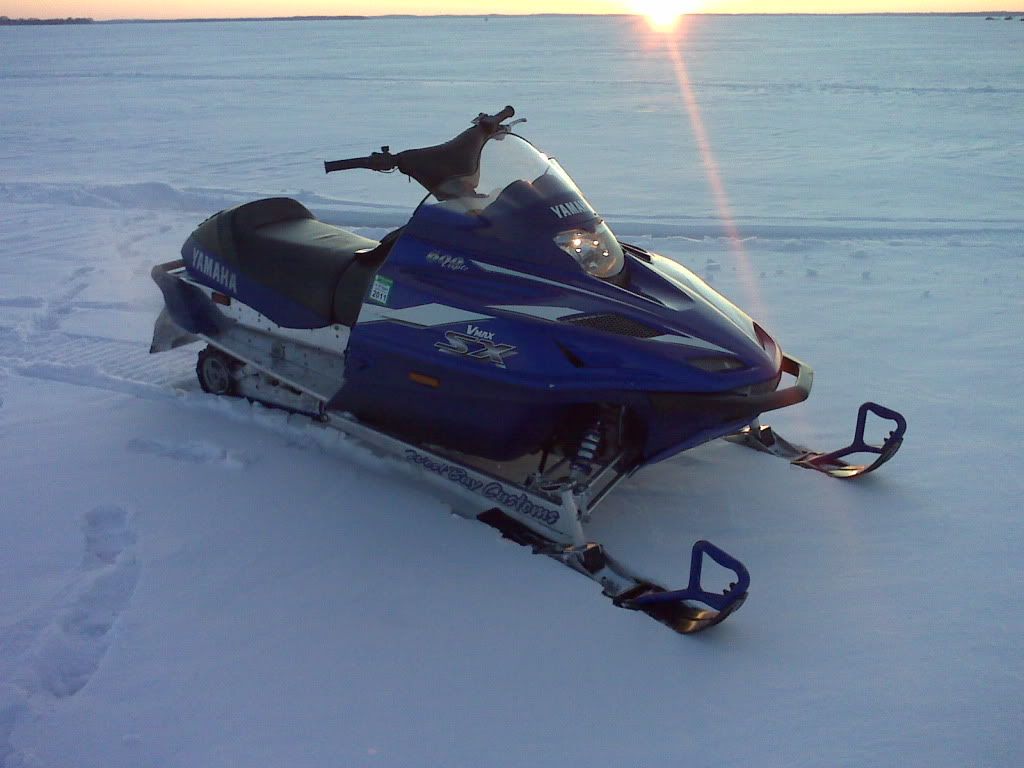

pic my 99 sx which is still for sale....
I put a 00' dual headlight/gauge pod "bigger gauges".....I used the 00' wiring harness BUT to this day it dims the lights alittle??? Although it didnt improve the visibility at night, it looks cool.
