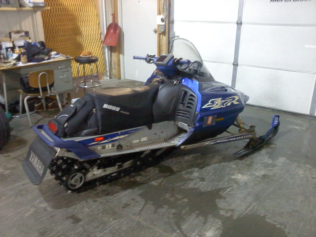

Here are some photos of the relocated skid with a 128" Hacksaw which is studed also. I am thinking this will be a good crossover suspension, more capable than a 121 but more manuverable than a 136. Note, the heat exchanger angle was the only differance to the tunnel. The initial ride is smooth and easy to control. Waiting to install Bender adjustable transfer rods

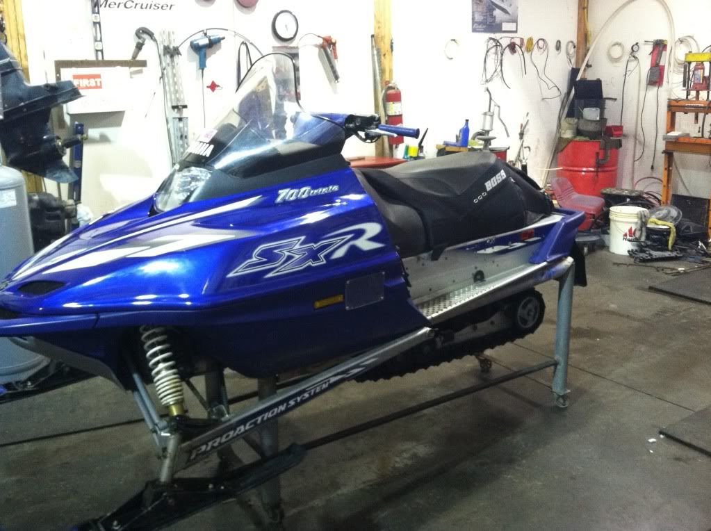

Yea, here is a photo of the OEM skid location with a 121. Seems too short. Not exactly the same angle as the photo of the 128.
