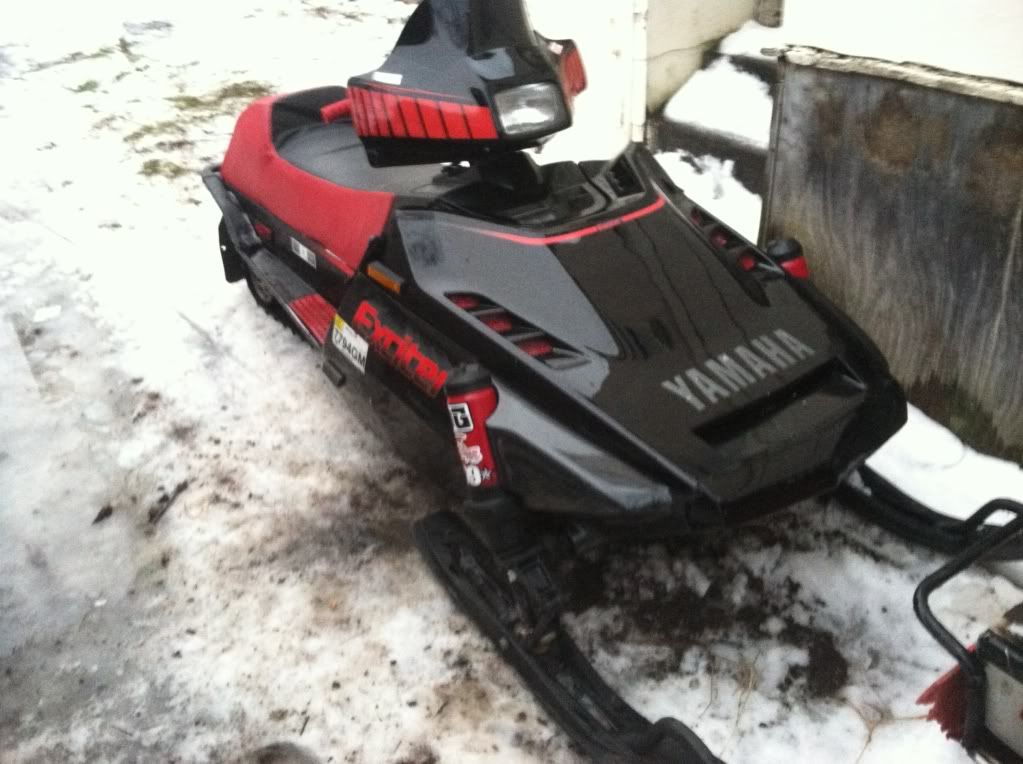

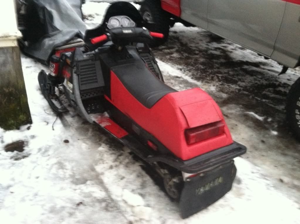

Hi everyone, Im a new member, gald to have finally registered. Anyways I got a 1989 yamaha exciter (38mm round slide mik's) for $400, bought a DG pipe (used for $50) jetted it 2 sizes up (was 320 now is 340 main jet) Needle is a 6DH7 on the 3rd clip position. The fuel/air screw is out 1 turn. The sled idles nice at 2000rpm and the sled runs good, except for a slight bog at wot from the midrange speed. From a dead start I can give it wot with snappy throttle response, but from the midrange to wot thats when the bog happens. I can feather the throttle through the rpm's and get the exciter to respond to wot better; either that or gas and let off, gas and let off, and also that seems to help me achieve a better wot response.
I mean, It's a beast from dead stop to wot, but then at about 40mph, it begins to bog a little until I pump the throttle. If I feather the throttle, without snapping it wide open, the exciter seems really crisp and screams, but if I hold it wot from dead stop it will go great till about 40mph, then it bogs just a bit.
I am wondering if I should get a set of exciter II needles (6FL82) and try them, or if I should just go with a pair of 330 jets. Maybe it's the floats, I set them to 18mm (eyeballed it), but decided to try to lower the fuel level to see if it alleviated the bog issue( which it didn't, only thing that helped was cleaning the needle valve and adjusting the air/fuel mixture screw) Any thoughts? Thx guys.
