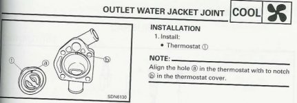

I replaced my thermostat last week and I'm going riding Thursday and I just discovered I didnt align the little hole in the thermostat per the service manual directions Is this going to be an issue as I really dont feel like taking it apart again til summer. : )
Apparently, there's a notch in the stat that when lined up with the housing it alows some coolant to circulate during warm up" but I dont know the importance of this?

it definitely sat properly when I reinstalled it. It has a gasket around the thermostat and it sat nice and flush. I dont expect it will leak but more concerned of the importance of this hole for allowing coolant flow.

the hole is only there to let traped air escape when filling, but if you have it bleed and its circulateing fine i don't think you have any think to worry about.

I did the same thing but didn't have all the coolant in yet. So I drained a bit out and opened up the housing to check only to find I put it in the same orientation as the old one, so in other words it was lined up, doh!
It will be fine though as long as everything bled properly.

I think that hole also allows coolant to flow as opposed to building pressure behind it when engine is cool (stat not open yet). As long as your rad cap is funtioning should be okay...maybe dont torque cap down tight?
