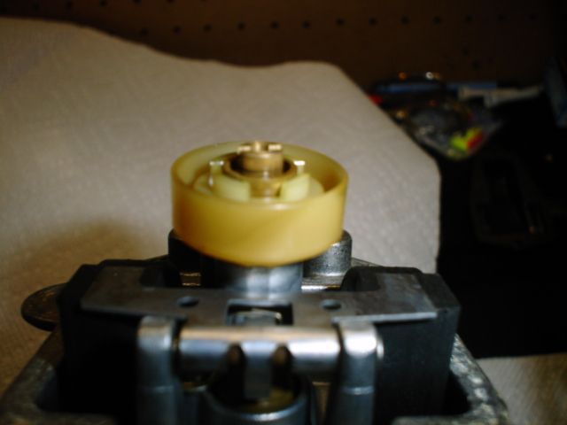

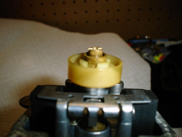

Cooper0809
Me too, cant remember if they just sit loosely in that groove at the top or if those tabs should be flush with the top.
tabs flush with top
http://i1129.photobucket.com/albums/m504/thiessen1/DSC03771.jpg?t=1356830584
sitting loosely in groove
http://i1129.photobucket.com/albums/m504/thiessen1/DSC03769.jpg?t=1356830584
tabs flush with top

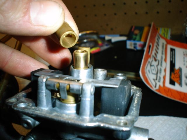

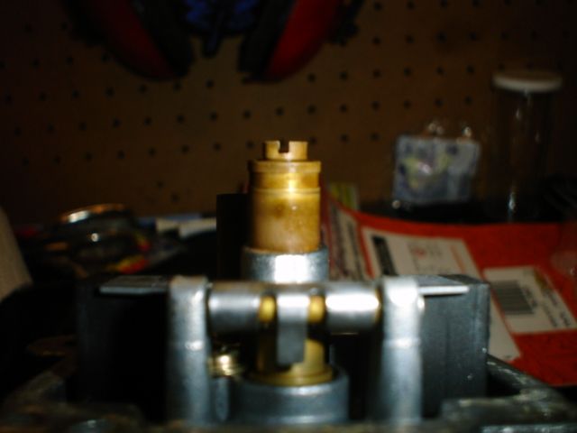

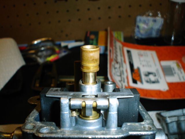

Cooper0809
YAMAHIZAL700 said:I think I may have installed the main jet incorrectly. I think I managed to flip the brass thing the plastic washer thing slides on. My jet is tucked up in the brass thing. Anyone done this too? What effect would u get
not sure about the effect, other than it might not run right. but I think that's what you've done. this is how it should be
http://i1129.photobucket.com/albums/m504/thiessen1/DSC03772.jpg?t=1356841733
I think this might be how you have it.....
http://i1129.photobucket.com/albums/m504/thiessen1/DSC03775.jpg?t=1356841736
http://i1129.photobucket.com/albums/m504/thiessen1/DSC03774.jpg?t=1356841736
super1c
Super Moderator
^^^ yup first pic correct and i always let mine sit loose in groove. Keeps the fuel around the jet for hardlong pulls. You dont hit the main very often, long WOT river runs! Corner to corner you never even hit it.
YAMAHIZAL700
Yep, there my sign!!!!
As some of u have been reading I have been chasing my tail thinking I got plugged jets but I think by having it the way I do the plastic washer maybe hitting the float making it not seat. This site totally rocks. How much tine would I spent trying to figure this out! Thanks guys. Kind of wish I wasn't leaving early tomorrow for patriots game. I'd really like to go out there and tear the airbox back out! It's too late tonight I guess. I will have a killer time now tomorrow at least thinking I've licked my problem. Go pats!
That is exactly how I have it in pic 2Cooper0809 said:not sure about the effect, other than it might not run right. but I think that's what you've done. this is how it should be
