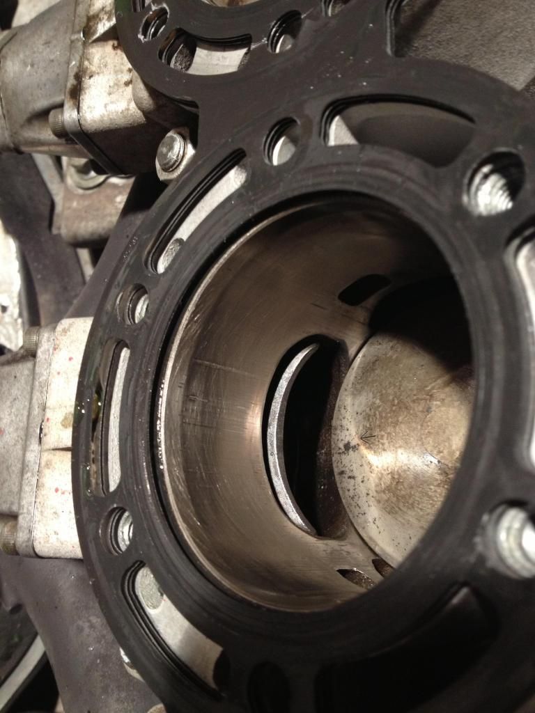

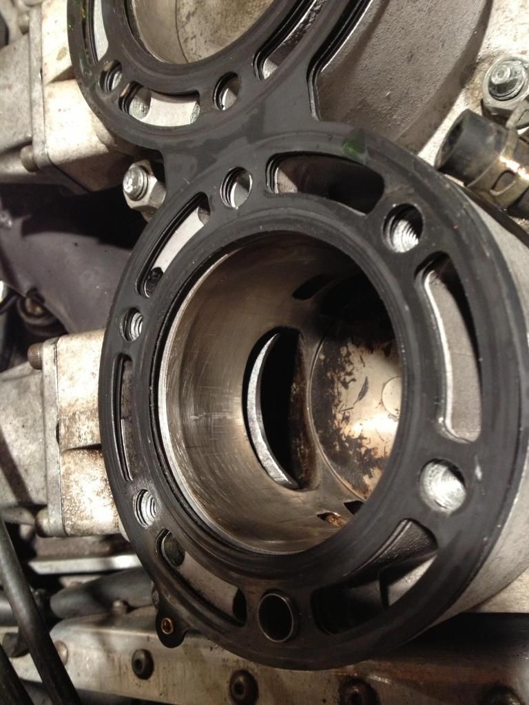

I ran a fresh rebuild in the garage for a few min, in the driveway for a few more. I then did about 4 laps around the house with a few throttle blips. I then pulled up next to the garage to do a visual inspection of the engine. As it idled it had a faint squeak, it sounded like a spring was chirping as it was shaking at idle. It was coming from the PTO side of the engine. As I started to look closer for the culprit it got louder, like a bad loud! I shut it down. I pulled plugs, it didnt even run long enough to put color on them. I started it back up with the oil cable pulled all the way out (I was thinking it wasnt hardly smoking, maybe the oil pump wasnt working). I pulled the head thinking I had squeaked a cylinder. Everything looked ok, there was a thin oil film on the cyl walls.
Here is the three cyl: the scratches on the cyl were already there.
