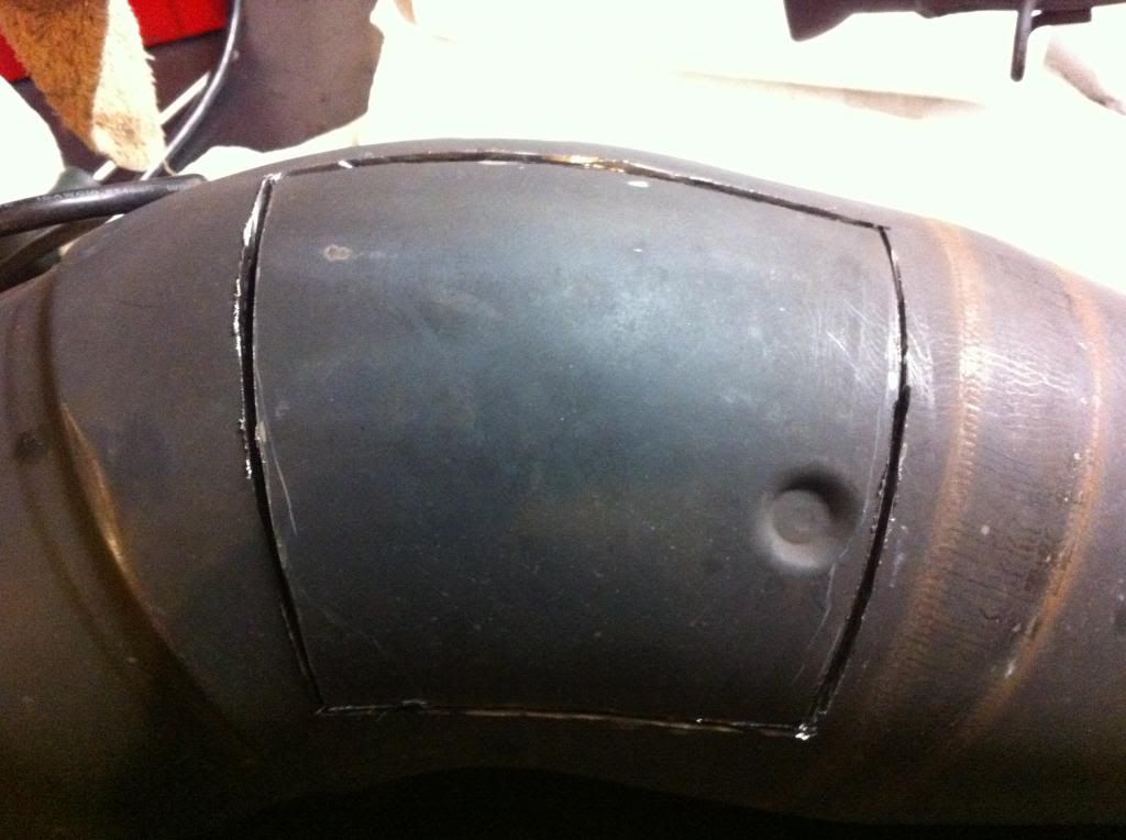

So, after talking to my local welding guru I started working on it. Here's what I found :
A couple of bucks

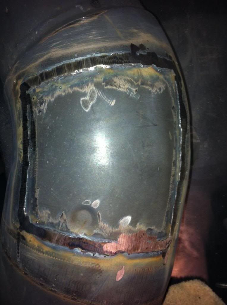

So I got it all welded up, painted and re-installed on the sled. Just finished taking it for a ride and no more intermittent dramatic bog or loss of performance. All said and done it cost me $20 to have it welded up !! Sweet !
Before the paint :
Before the paint :
