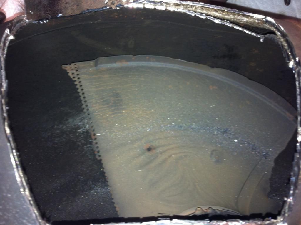

I had an issue a few weeks ago with the pipe, there was a big piece of metal floating around in it. I had to cut it open, remove the 4"x5" piece and have it welded back up. I had blown the pipe off of the collector before I had it removed. I've blown the pipe off of the collector once since I took that big chunk of metal out of there. Is a restriction the only real cause for having that pipe blow off ?

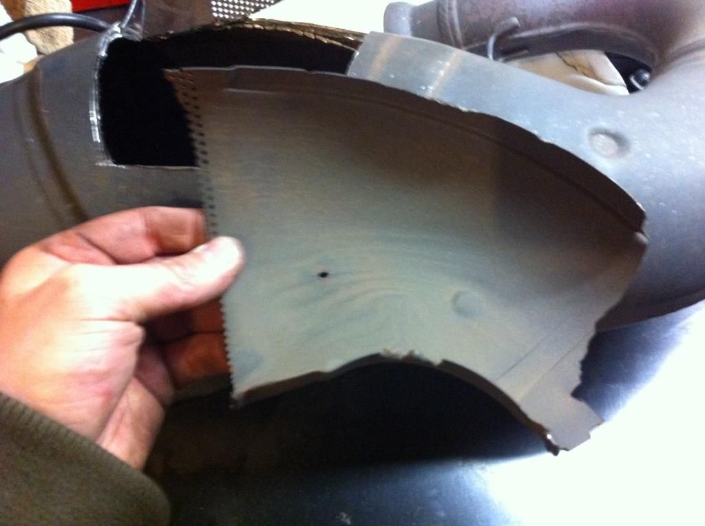

Here's the piece of metal I pulled out of my pipe :
There was another smaller piece that came out of there, it was about 2.5"x3".

Summitt22
taylzee said:I'm talking about the main needle and seat in the float bowl. It's the part the floats are connected to. It's basically the fuel valve that the float operates.
Check the tech section for the carb part break down and proper cleaning methods. If the needle is stuck half way in the seat, it won't shut the fuel flow off and it will keep the fuel flowing into the float bowl. Fuel coming out of the vent lines is usually an indication of this. The only other thing that comes to mind is a blockage in the exhaust. It could be that your exhaust side skirt broke off the piston and is stuck in the manifold.
You could pull the exhaust manifold and roll the motor over to have a good look at the exhaust side of your piston and inspect the manifold. You can also get a good look at the intake side of the piston if you pull the reed cage while you have the carbs off to inspect the needle and seat. I would say you want to pull the seat right out and look behind at the intake passage.
This was exactly what I needed to do, and it solved the issue. I assumed that because the needle moved freely in the seat that there wasn't an issue with it, of course what I didn't know was that the issue was between the seat and the body of the carb. Thanks again taylzee !!
