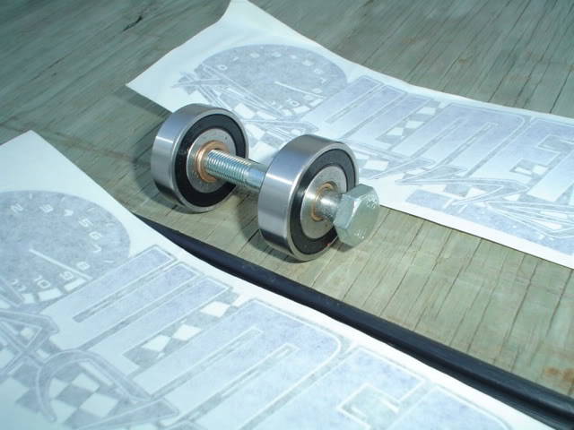

I use this track rub kit from Ulmer racing on my Apex https://cdnmedia.endeavorsuite.com/...8fc24537d4/track.jpg&v=1451933962759&w=345pex.
