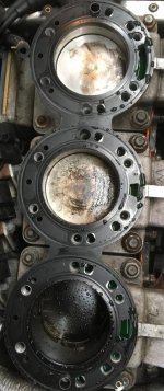

So I removed the head yesterday and it looked like that;
In the bucket is coolant that was in the pipe, approx 3/4 of a pint. The head was torqued as per specs in proper order.
When I look at the water rails in the cylinders they are all full off coolant and equal in all three.
Should I be concerned about coolant going down in the bottom, crankshaft area?
Thank you
Thank you
Mac
Inspect that head closely. It may be warped and they are cheap to replace. I would drain the coolant prior to before taking the head off. Go slow when
pulling off the head off next time and try to isolate which cylinder is the leaker.
No concern with coolant down below as long as its not long term.
