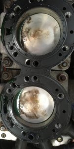

Took everything apart, had the crankshaft rebuilt (bearing toasted),
replaced every parts in the water pump
got a used cylinder and piston that was in good condition and yes reused the 2 other one, but new rings on all new circlips, new needle bearings....
new fuel pump, new gas tank filter
new gaskets
new carbon reeds
new carb kits
new power valves kits
I did use a straight edge on the head at different place as well as on the cylinders and all seem to be perfect, straight.....

UPDATE!!!!
So I finally received my new bolts for the cylinder head. Torq it in 2 steps as mentioned in the service manual, this time I went to 35 of torq, and again coolant all over
Tried the opticool gasket as well as the Yamaha and both time all cylinders get some coolant and it leaked into the pipe, half a cup in no time.
placed a straight edge on the head and the cylinders and all seem straight.....I dont know what to do anymore. really discouraged.
Trying to be logical; If the head was bent or the cylinders not straight would I not have a leak of coolant seeping outside where the head seal with the cylinders???

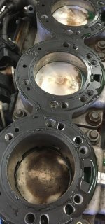

Ill take all cylinders out to begin with I guess and now so many coolant leaked while trouble shooting that I am afraid that it made it way in the base...
Vmax xtc 1997
UPDATE
I removed all cylinders and looked down in the base and it was full of coolant. I hooked a piece of gas line on a shop vac and sucked all of it, approx 2 full cups...
When I rebuilt the engine (my first time attempting a rebuilt) I did removed the water pump shaft to replace some parts; bearing and seal if I remember or maybe just a seal..... but I definitely changed something. Can it be leaking from there by seeing the amount of coolant down there?
